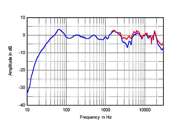

Well, for what it’s worth, here are some measurements of the older Alexx (not alexxV).
Their spec may be “in-room” because the close mic / quasi-anechoic measurements show the system is about -6db at 28 hz and ~-10 dB at 21 hz.
If you notice the spatially averaged in-room measurements in that article, you’ll see it extends to ~20 Hz and below.
The exact shape of our roll-off is somewhat different (with the PR tuning slightly higher) but I just mentioned this for the sake of illustrating the different between in-room versus anechoic 2pi measurements etc., since there seems to be some confusion.
