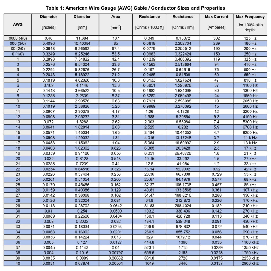

People oversize wire, less resistance and can hear a difference because of that, I wish my hearing was still that good, I don’t know what 4sqmm wire size converted is, I’m bad at converting metric and I don’t have my code book here to look it up in the tables of sizes.
The chart above is for size but I cannot find a chart able to take into account also the difference for 220V vs 120V
If I’m understanding what you’re after correctly, each hot line of 220v would stay within the amperage rating of the conductor: it doesn’t double up because you have 2 phases: 3300watts divided by 220 = 15 amps, per hot line: you would need to up a wire size; 12 gauge for 20 amp rating
So now you would be within the 80% rating of the conductor at 20amp

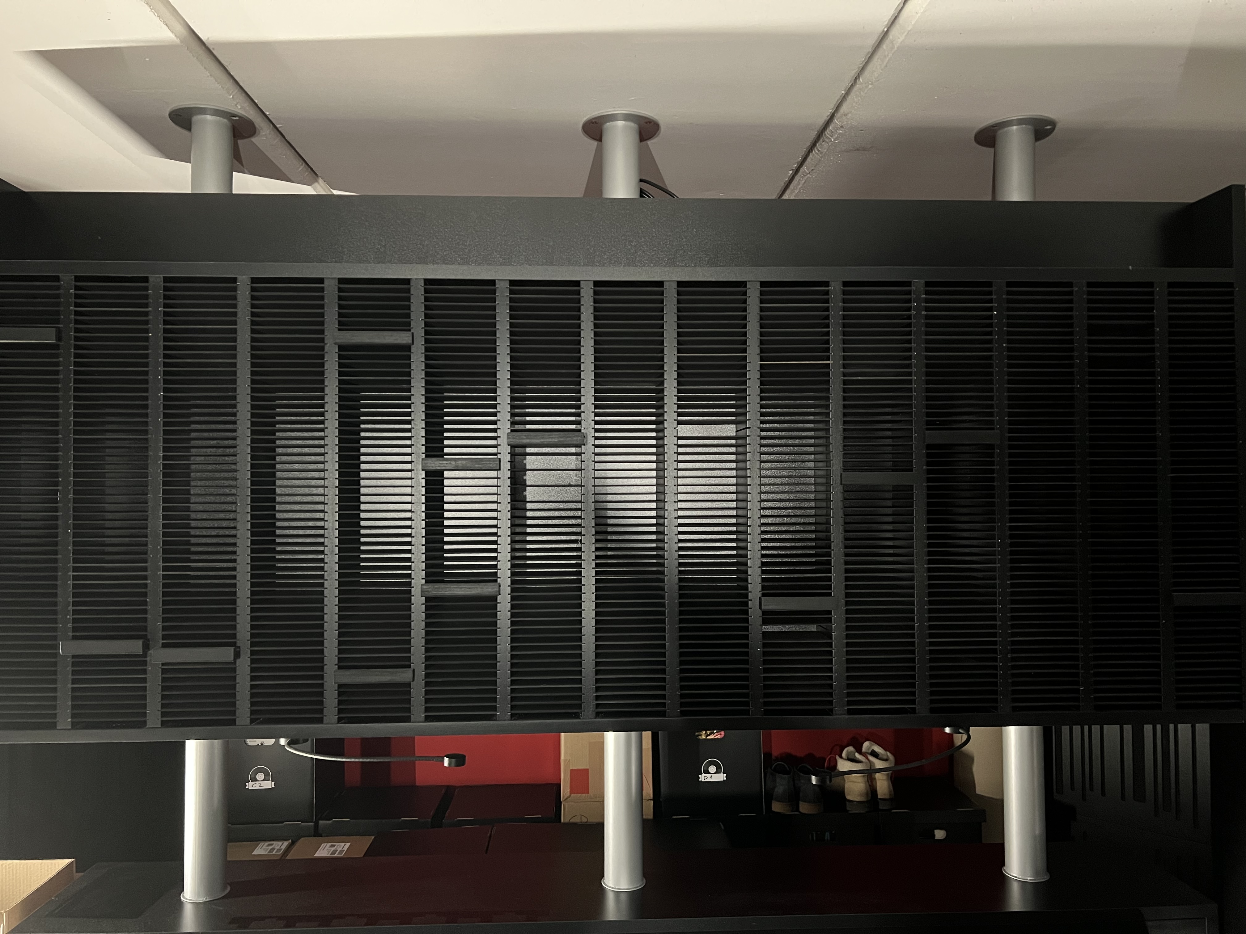

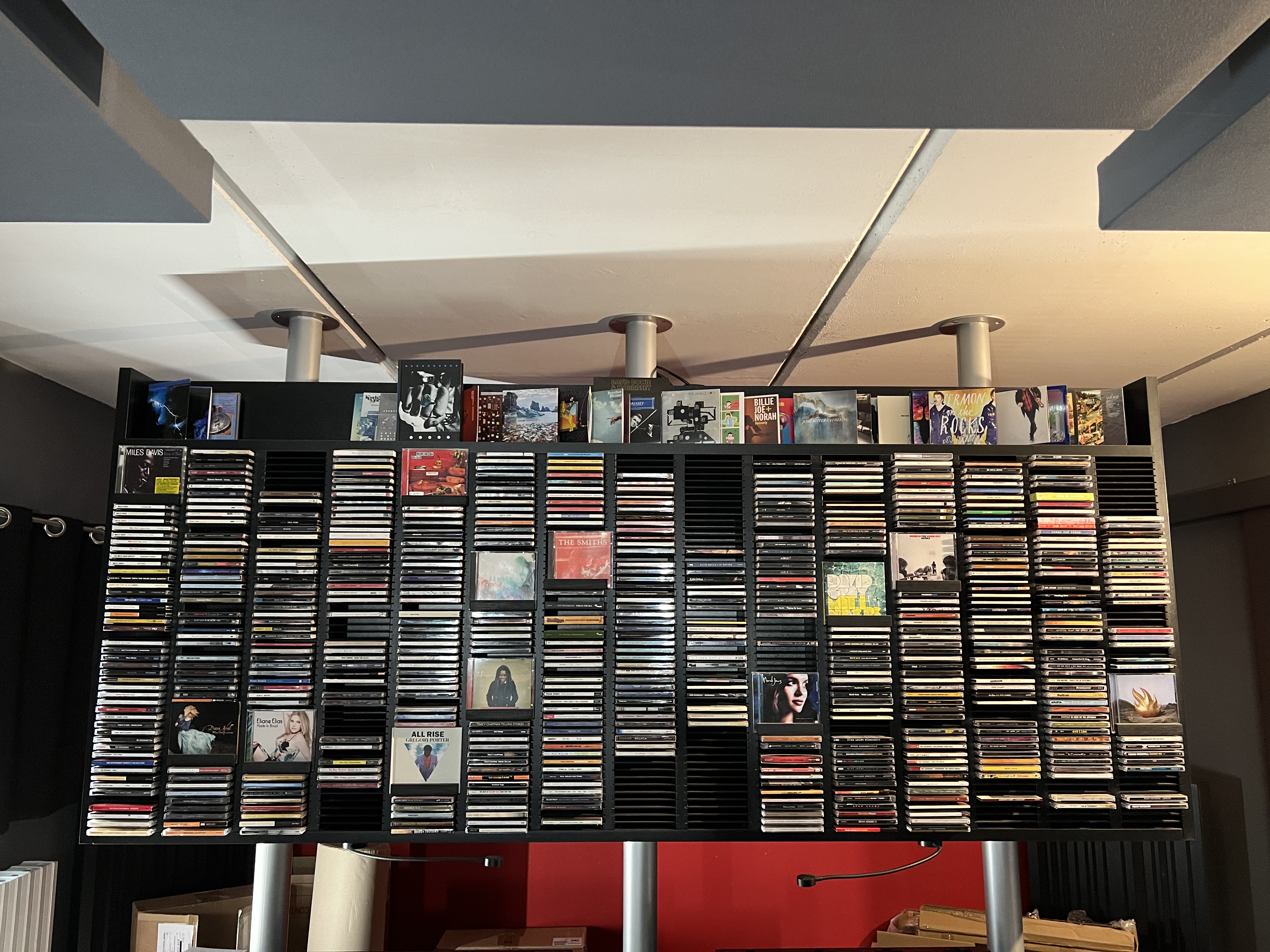

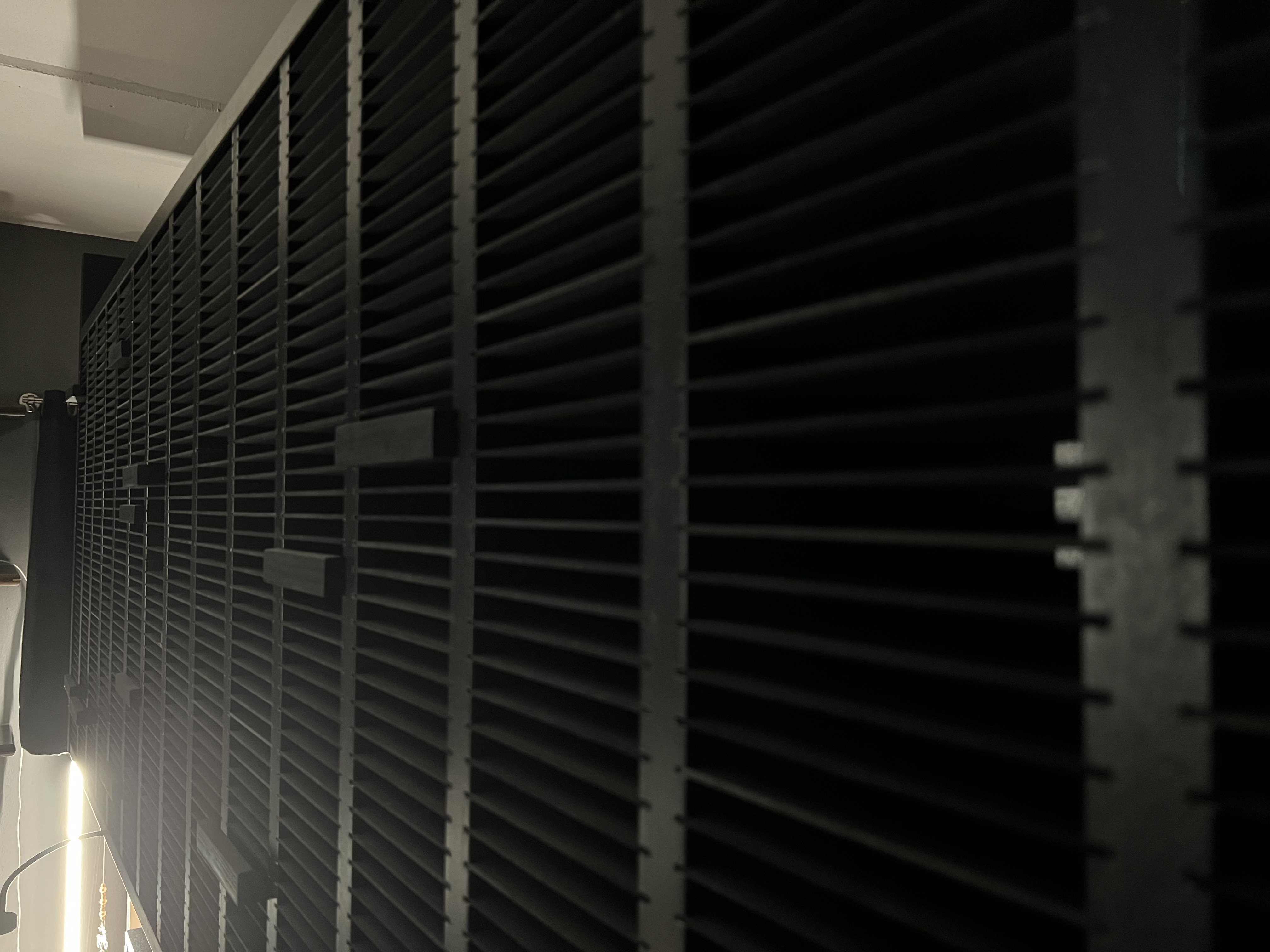

Third weekend of hard hard work! All the shelves are now totally empty.
Before
After
Before
After
Almost 50 carton boxes full of LPs and CDs, perfectly in order and labeled.

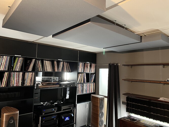

A bunch of acoustic treatments have been also removed.

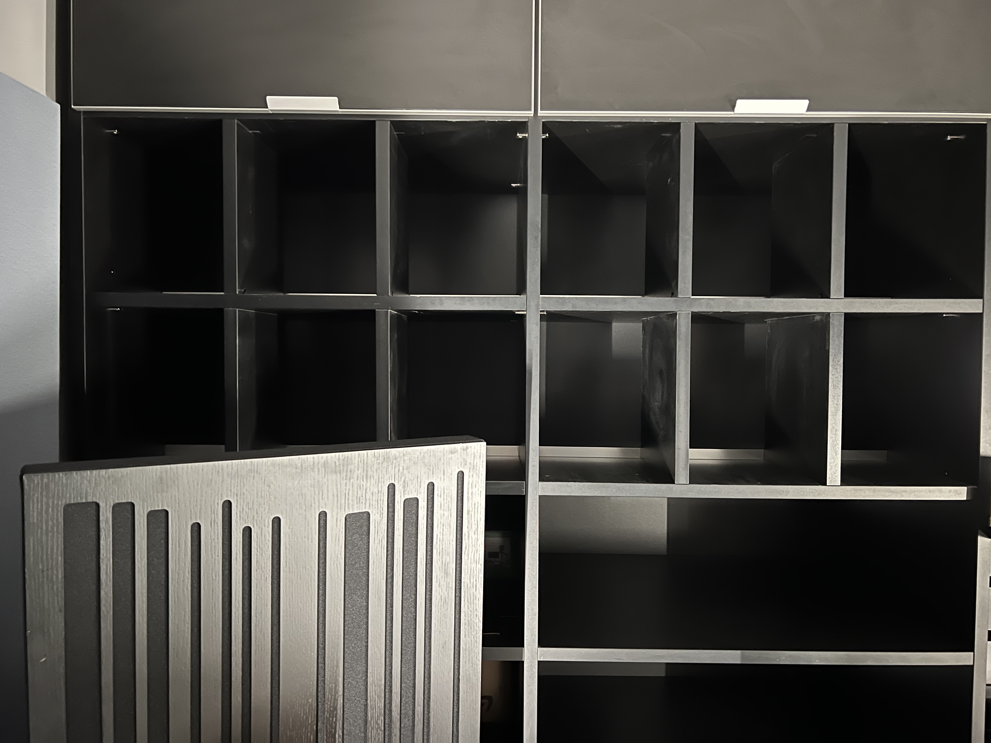

Here a more clear view of what I’m fighting:
a window door on the right wall
an empty door way on the opposite left wall
The 20th March is much closer day after day, can’t wait! So anxious to finally have the room perfectly symmetrical rebuilt.
