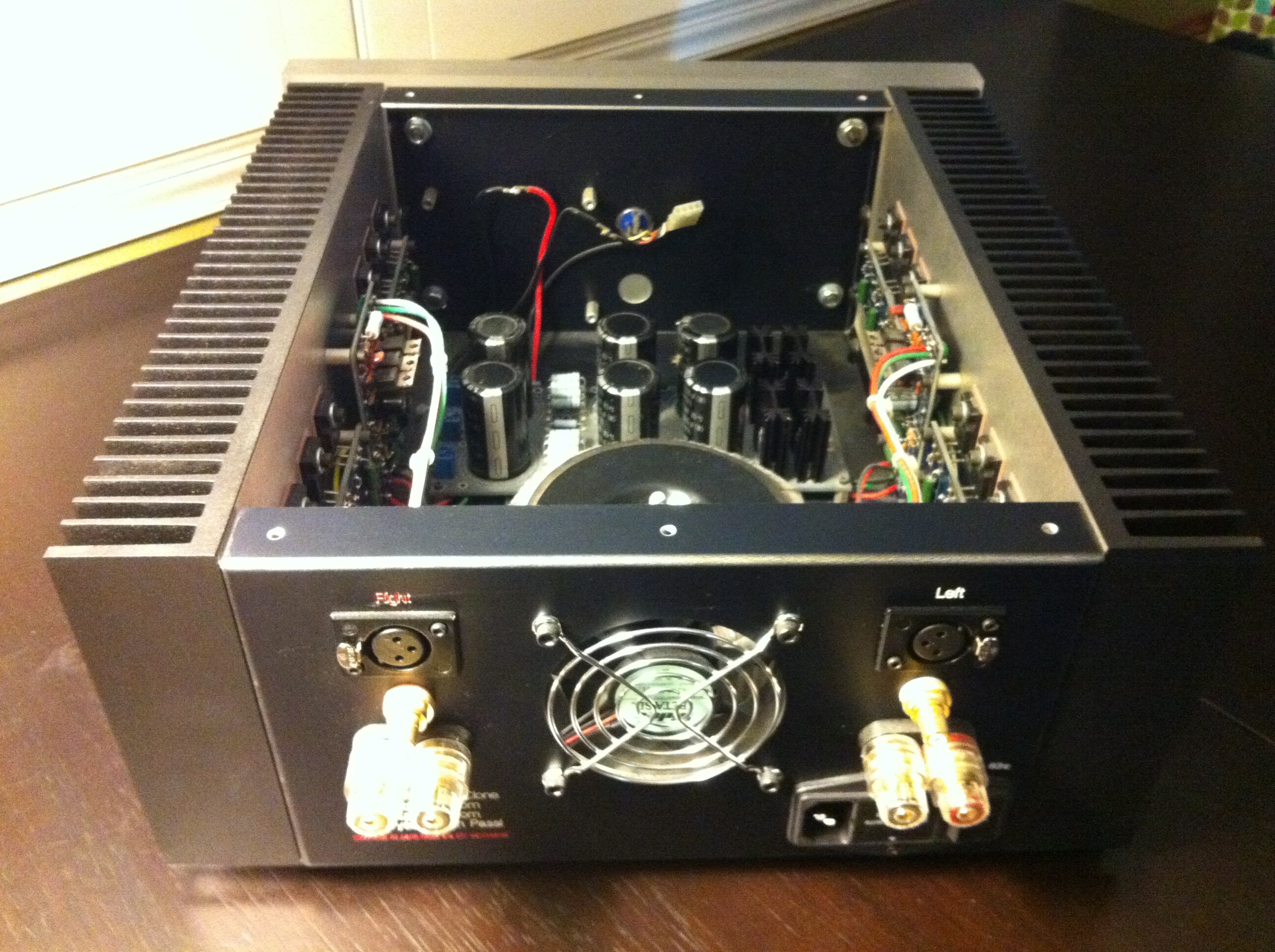

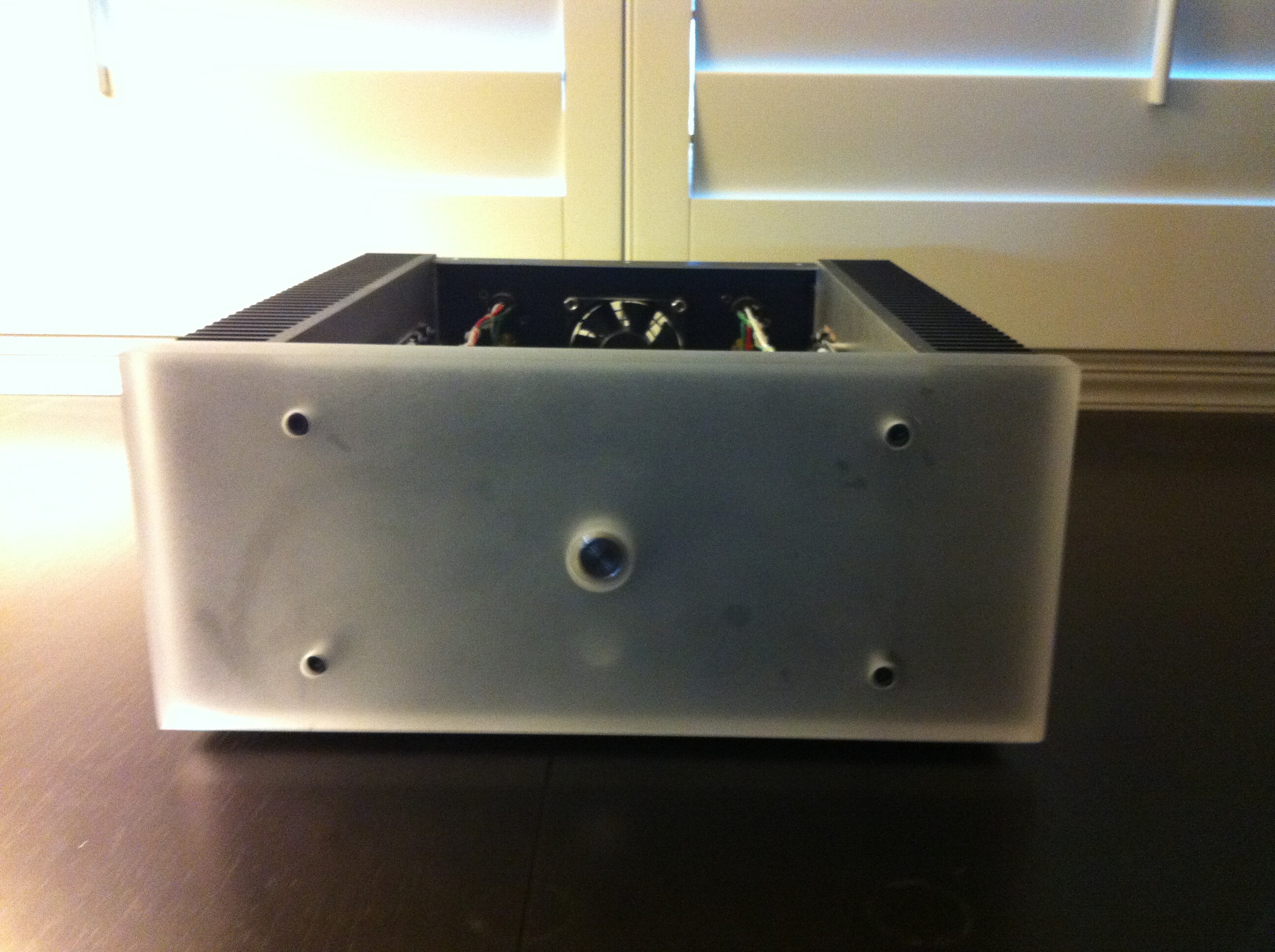

My system is:
  • Homebuilt/100% DIY Pass Labs Aleph 60 built as an Aleph 30 (see attached pics)
    ** I had a little help directly from Nelson Pass interpreting his schematic in the gain stage.
    ** It has a fan, but not hooked-up. I build a could of these chassis’s in my shop to DIY tinker.
  • Bi-wired Magnepan 1.6QR’s
  • Mogami balanced interconnects & speaker wired
  • OPPO Sonica DAC (which I’m looking to replace with a PS DirectStream DAC when prices drop for new model)
I’ve never auditioned a PS audio Amp, I’m sure they are amazing. Pass Labs Class A is just stunning. Warm and romantic like tubes, yet lightning fast transient response with minuscule noise floor. Sonically it has all the advantages of tubes combined with advantages of semiconductors.
