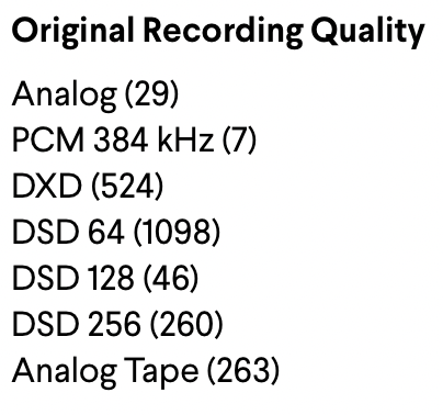

Only just over half of the items listed on NativeDSD are actually recorded in DSD. The rest are PCM or analogue transfers.

On nativeDSD, and there may be other DSD sources, there are 260 titles that originated in DSD256. Anything issued higher has been upsampled. The vast majority are DSD64, which is the limit of the Sonoma system used by Octave.
