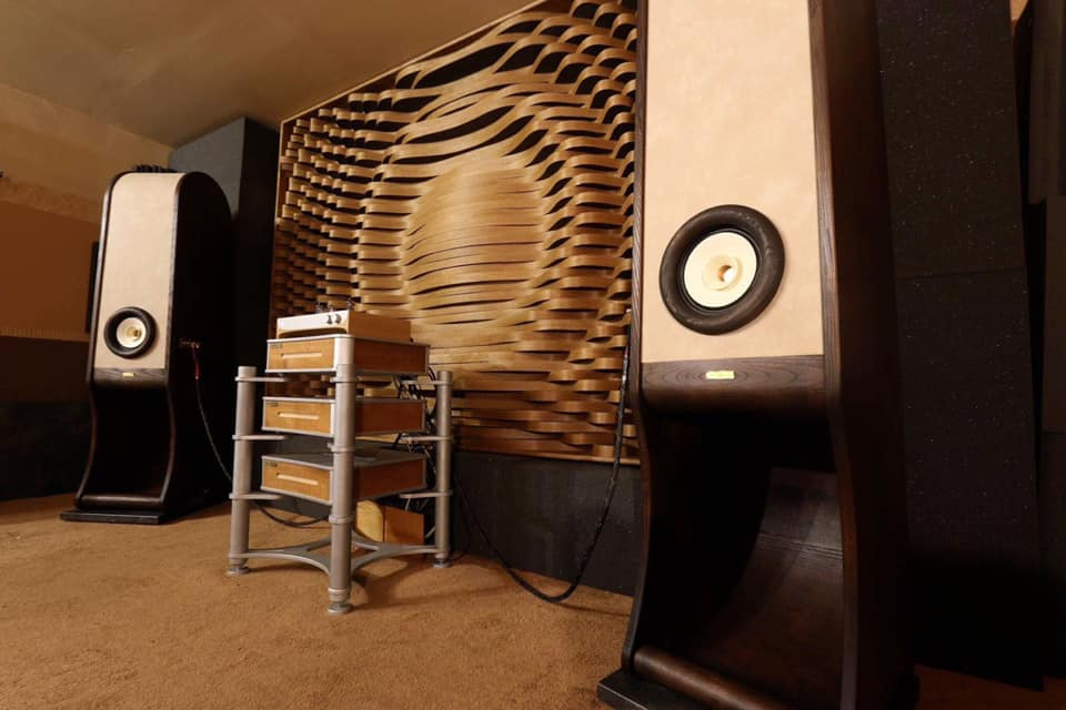

New Hybrid Acoustic Diffuser is already placed even in a listening room in Roznov pod Radhostem, Czech Republic. The diffuser will soon be available for purchase. Several sizes are going to be offered: 1x1 m, 2x1 m and 3x2 m.
(RDacoustic)
(RDacoustic)
