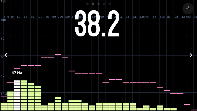

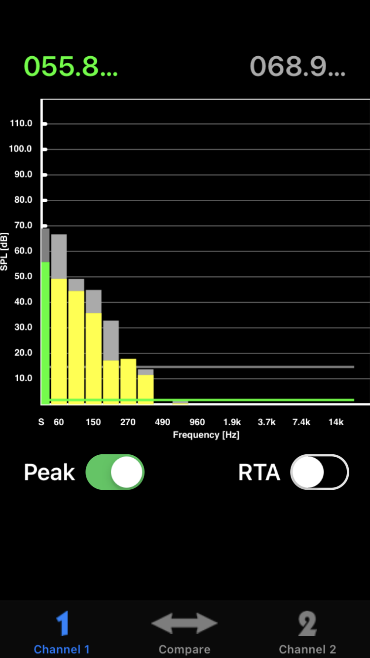

I don’t have an actual spectrum analyzer unit - I’m using the iPhone SPL Spectrum Analyzer and Decibel X apps. This is the best I can do with what I have.
The 1st picture is the SA app showing the frequencies when the phono input is selected.
The next three pictures were recorded with the Decibel X app, portrait and landscape modes;
the third picture is the phono input with the preamp nearly maxed out from 1 foot away, and the 4th picture is another input selected - also the reading I get when I have the volume down.
Thanks for these as they are confirming what I suspected. I am not sure how familiar you are with phono circuits so I apologize if you already know this. Phono preamps have 40-70db of gain compared to CD, Tape Streamer, etc. They need to amplify a .0002V too .05V signat up to 2V which you can see is 200-1000x. In addition, they apply an RIAA filter which rolls off from 20 Hz to 20K Hz a total of 40 db. The consequence of this is that all AC-powered phono circuits will exhibit higher low frequency noise. The net is that it is normal to hear more noise and especially hum from the phono output than any of the other line outputs.
If you set your SPP gain appropriate for your cartridge (which if the Zephyr should be MM and Low) and set the volume at levels that you actually listen to a record at, then you should not hear any hum when the tonearm is queued up from your listening seat. I expect that will be the case based upon your tests. Therefore, you should accept this as normal and sit back and enjoy the music.
