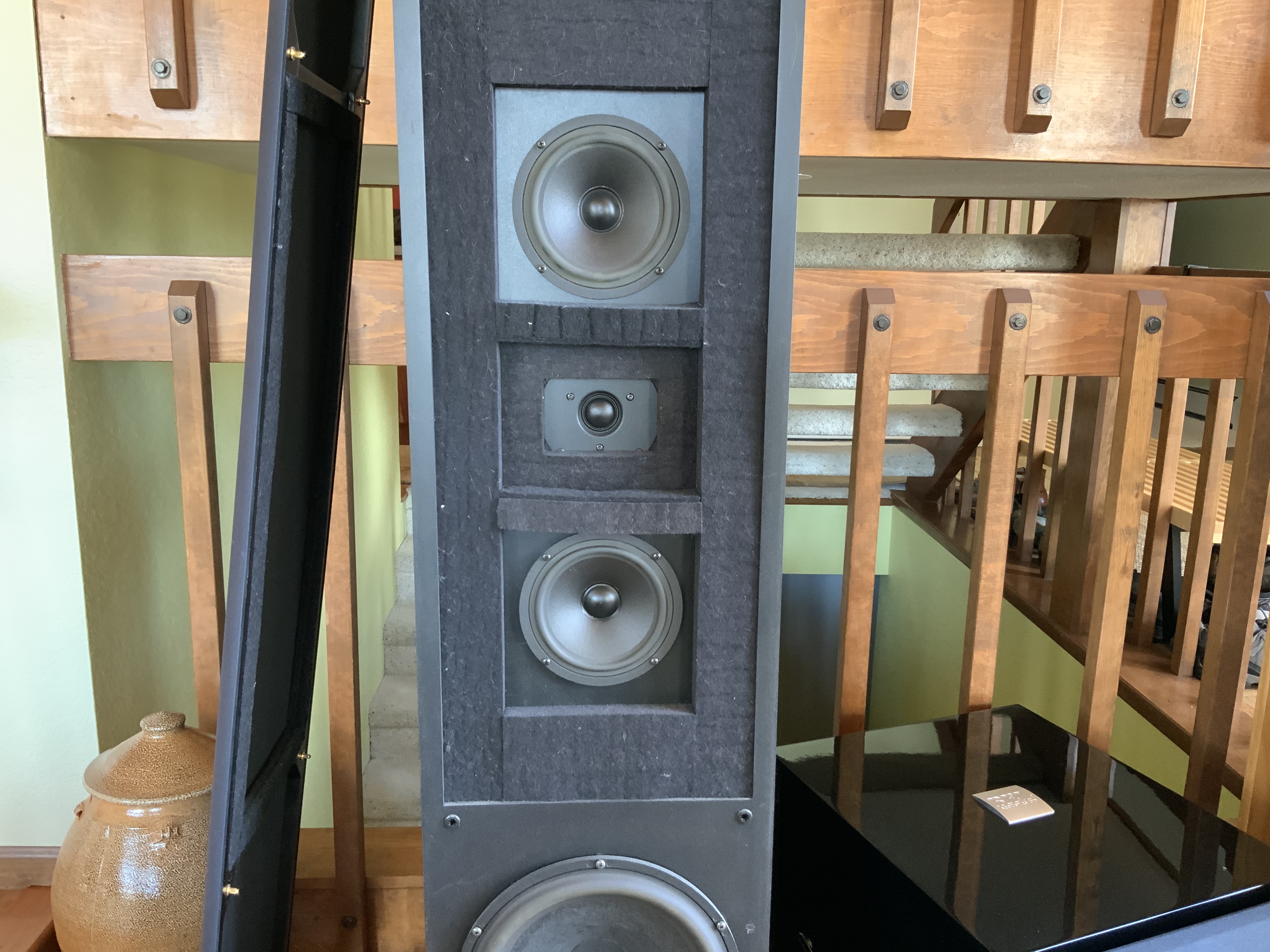

This reminds me of the hand-trimmed felt surrounds John Dunlacy created for his speakers.
Like these, Elk??
Just for the sake of accuracy, I believe you meant John Dunlavy.

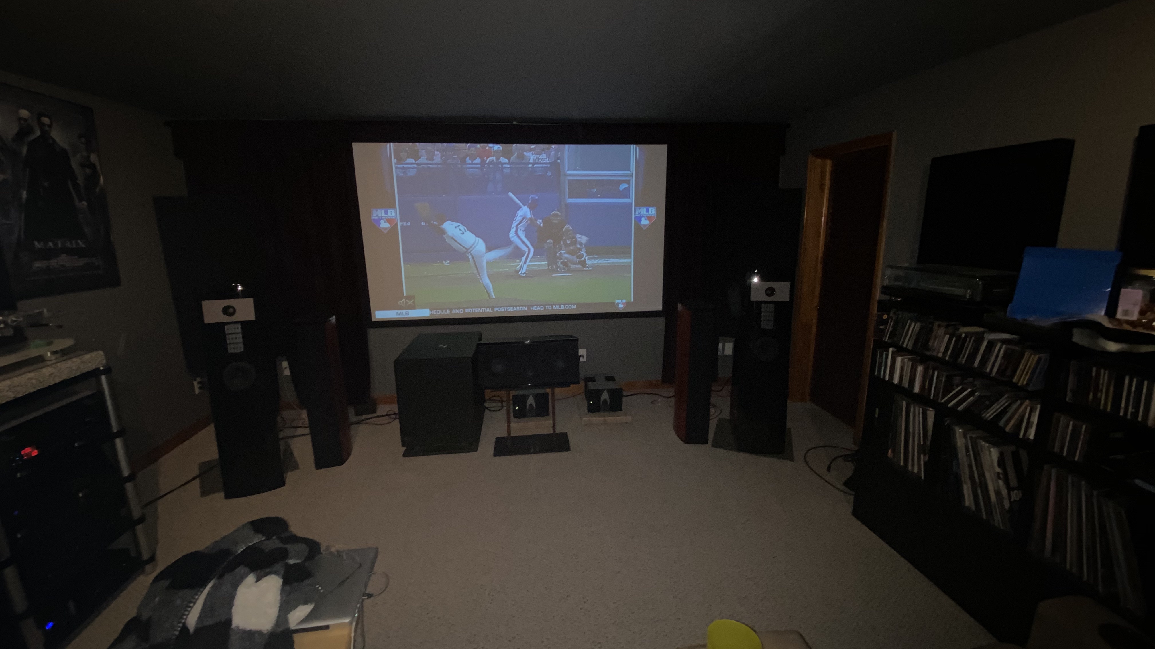

Almost forgot I had a set. Put them on just to listen to a few familiar tracks. (Excuse the mess, been moving things around today)
Vandersteen has had felt around their tweeters from their beginning.
Plus no baffle, at least not in the 2ce Sigs I had years ago. I very much liked the sound but they were just too big and were sold during a move.
