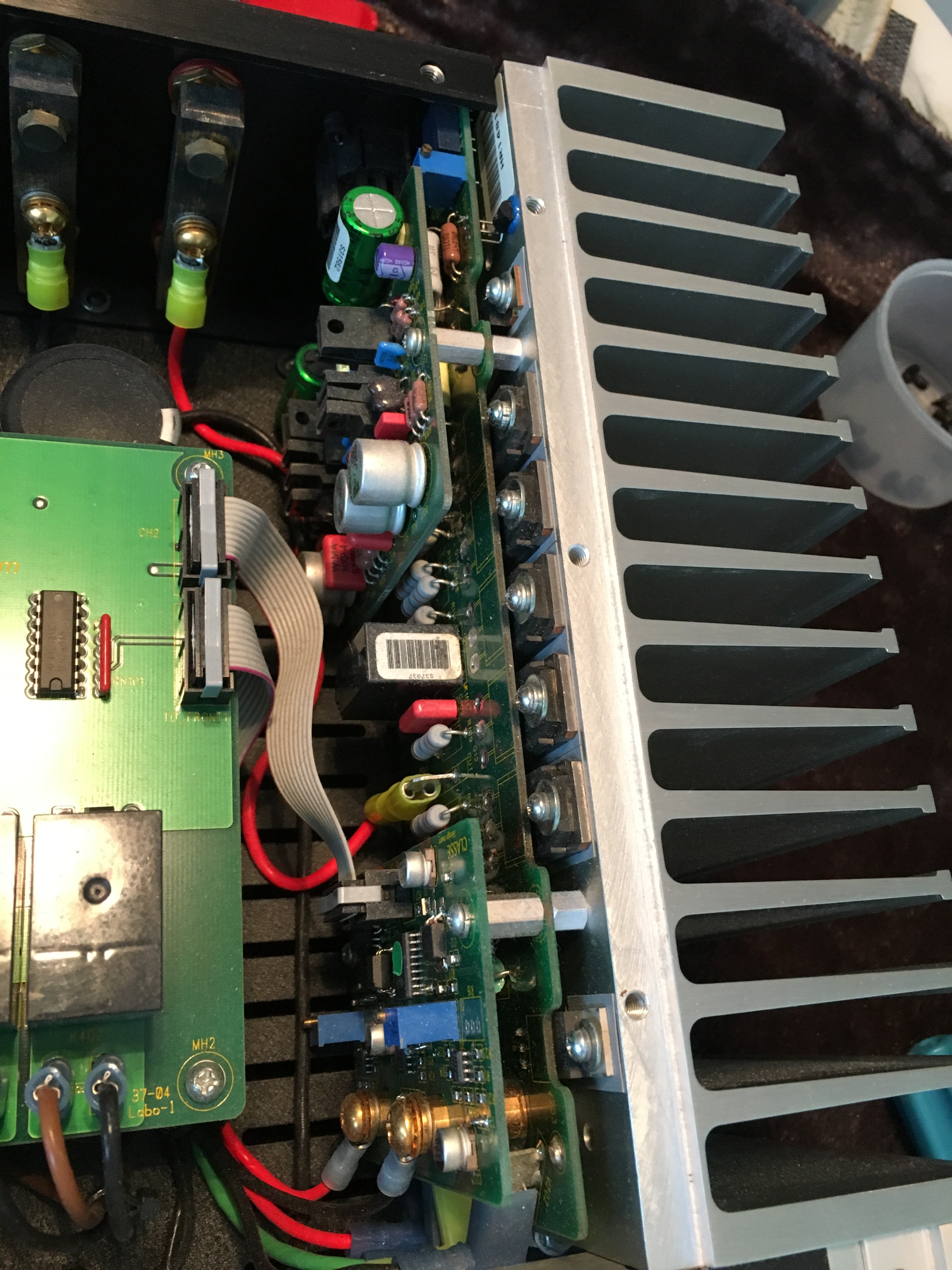

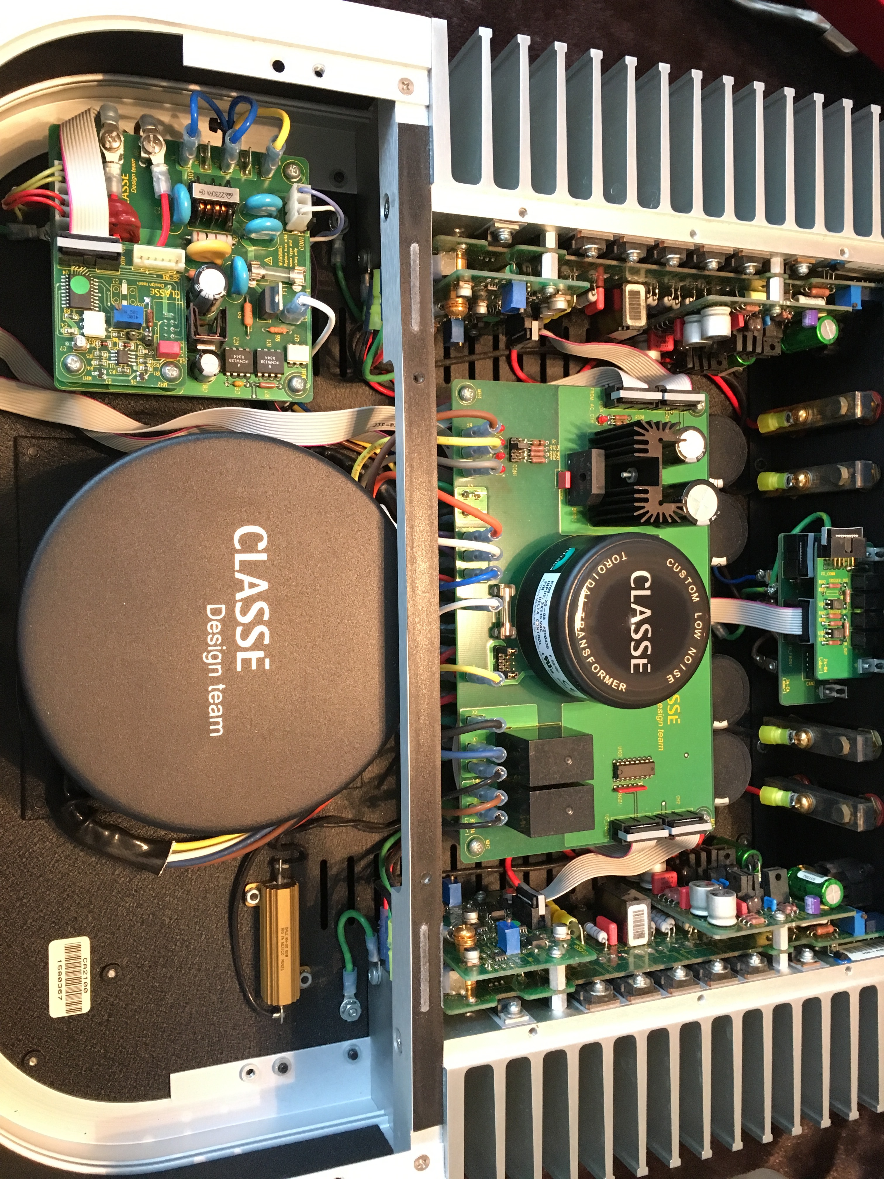

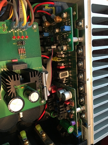

There where 2 main adjustments to check;
DC offset and either voltage or current ( I can’t remember which ) across the output devices.
In the center rear portion of the amp was a stack of capacitors and on top of that stack was a circuit board with 4 pots and 4 small ceramic fuses that where mosfet fuses.
2 pots where for the right and left channel DC offest adjustments and 2 pots where for the right and left output device adjustments.
I think that the DC offset had to be adjusted to zero or as close to zero as possible first for each channel.
Then you would take readings across all of the output devices for each channel. There was an average range that the devices had to be within. I say average because with my amp, Classe used a variety of output devices and removed the info off of all of them. I estimated by taking readings, that there were 3 - 4 different output devices. If the output devices average did not fall in range, then you would adjust the pot.
The output devices in my amp where on both the top and bottom of the amp, so both the top and bottom plate had to be removed.
My amp had a main fuse, 4 mosfet fuses and I think 8 rail fuses for the output devices. The main fuse and rail fuses where easy to check in my amp. You must drain the cap bank before trying to check or remove a mosfet fuse, they are charged by the caps at a high voltage, so beware.
