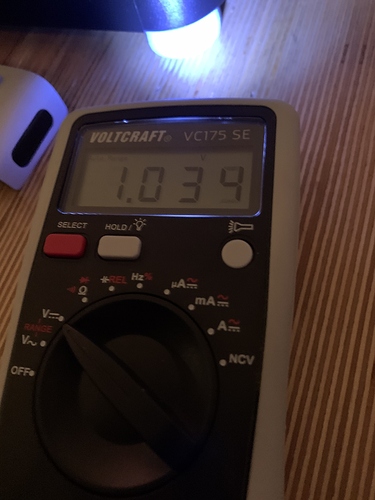

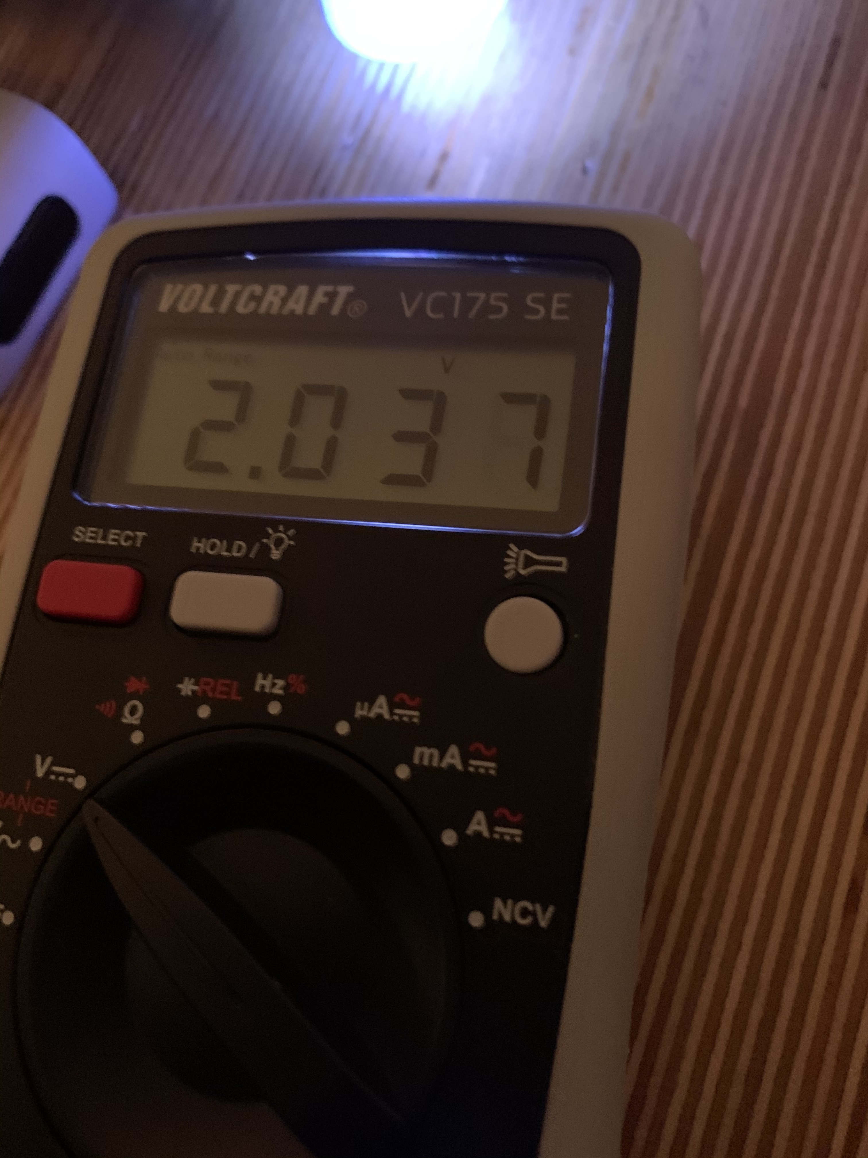

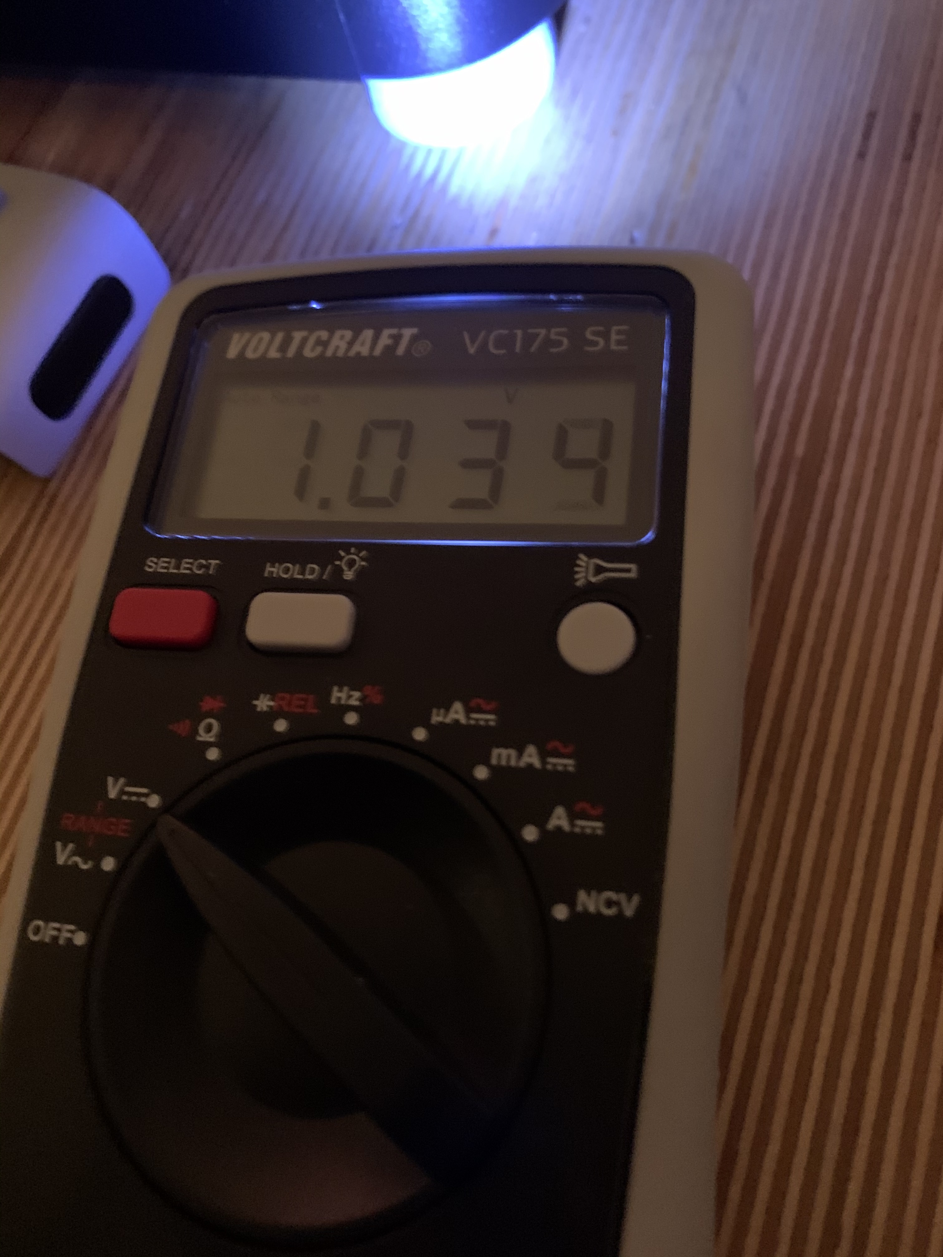

I measured 2 Volt at the left channel and 1 Volt at the right channel.
