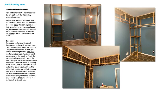

Hi Gary, thanks for keeping the thread alive. Since I was the one who started it, I will give an update to my project. I had a sauna to build first and just finished that, so I’m starting on my room treatments. A big shout-our is due to @MTB_Vince for incredible advice in what I should do with my small room. Basically I’m building bass traps in every corner and along where the ceiling meets the walls. Then I’m building several different types of acoustic panels - absorbers and/or diffusers - and experimenting with their placement. I’m also going to play with adding panels of pegboard on some of the bass traps to not deaden everything. So the idea is to create a lot of modular components I can move around, add things to, etc… It’s going to be an interesting project.

Hey Vince, I just wanted to give you a quick update on my progress treating my dedicated (but small) sound room. As I told you in an email, when I first fired up my system in the untreated room, I was horrified - I’m not sure I’ve EVER heard something sound so bad. But you told me to persevere, so I held my nose and moved on. The bass traps are done - not covered, so it looks like the bowels of hell, but I decided to hook it back up and see what happened. OMFG - it immediately, with no further treatments (I even forgot to throw down a rug), it sounds better than any system I have ever owned. This is all just rough placement (I’m using Paul McGowan’s new book on The Loudspeaker) and even without much of anything, I’ve got a great soundstage, imaging beyond my speakers, speakers disappeared. I have no doubt the new M1200 mono blocks are doing wonders, but I have never heard so much improvement from the same set of speakers. I’ve got lots more to do - the room is too small, so I’ve got more bass to deal with, panels, ceiling, and moving stuff around. But right out of the gate, your help has been so appreciated. Thank you so much! For any of you who don’t believe that treatments can add $thousands to the quality of a modest system, you have GOT to try. Can’t remember where, but I recently saw a priority list of expenditures and room treatments was higher than speakers. I’m a believer.

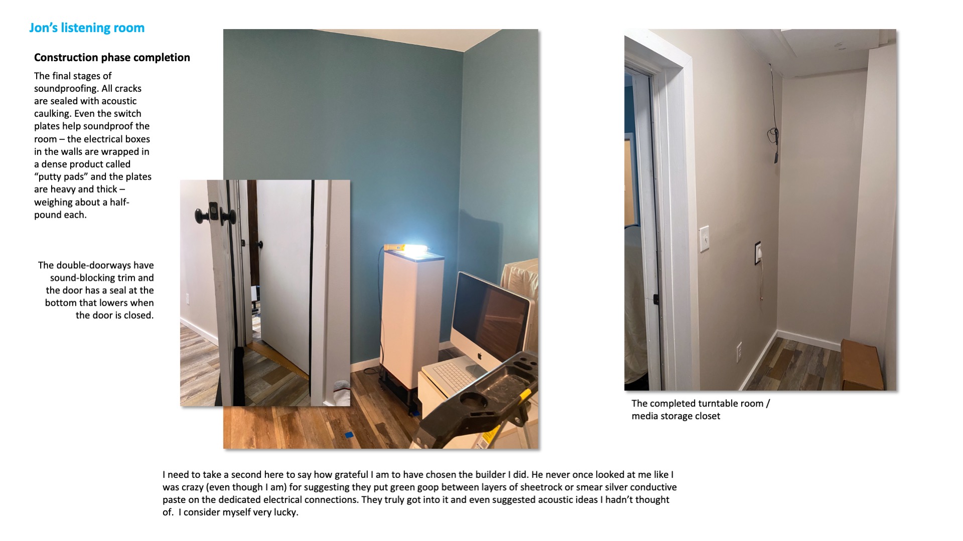

Well, it’s finally finished (for now at least). Your time and quality advice were really valuable and practical for me getting the best bang for my work and money. The sound is better than I could have imagined. OK, yeah, I did upgrade my amp (PSA M1200) and turntable and cartridge, but no way did those alone change the whole nature of what I listen to. Below are some highlights from a show-and-tell PDF I put together that might help others see how this can be done relatively cheaply - yeah, it was a bit of work, but what a difference! If anyone here would like to see the PDF, message me here and we can trade emails.

Probably nobody needs to go to the lengths I went, but I can honestly say that everything I did had a sonic effect. Sort of the same thing as with components and peripherals - if you change out you speaker cables OR interconnect cables OR power cables, you might not notice, but when you do all three, you notice. So was it the dedicated AC or the soundproofing or the internal treatments that made the biggest difference? The answer is yes.
