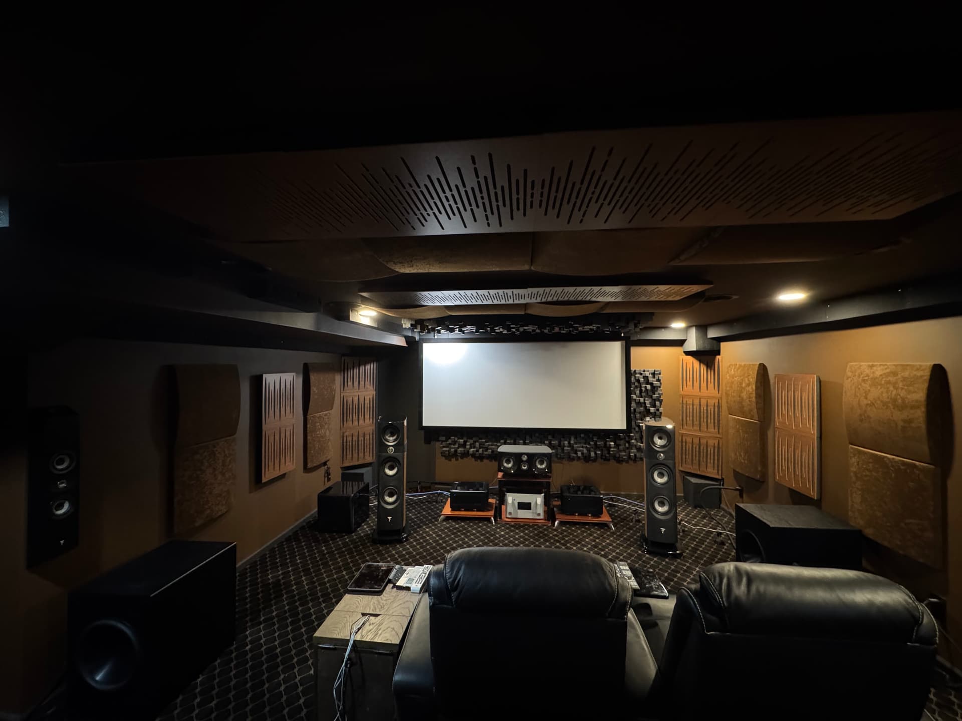

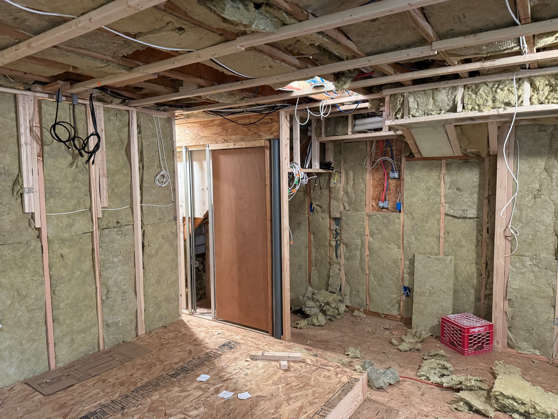

Here are some pics of construction and final

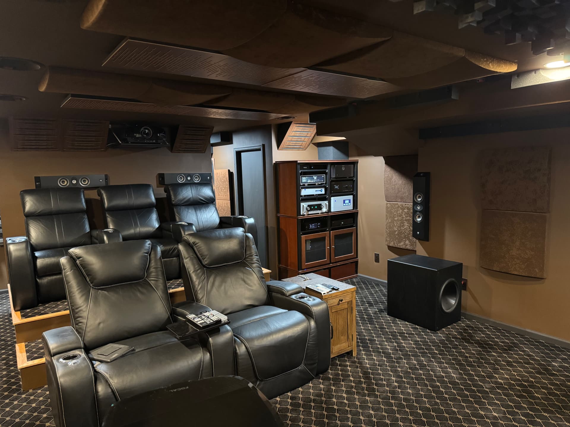

Framed in room. Used rockwool all sides and covered with Sonopan and the Sheetrock. I had Vicoustics do the design for where to put panels. I added some foam along edges. For music it’s pretty good sound proofing. But movies with the 3600 watts and 4 15” cones not so much.

Oh yeah. When I had them design the treatment pattern I said two channel first then HT. I ended up changing screen material to acoustically transparent so the wall of diffusers would do their job.

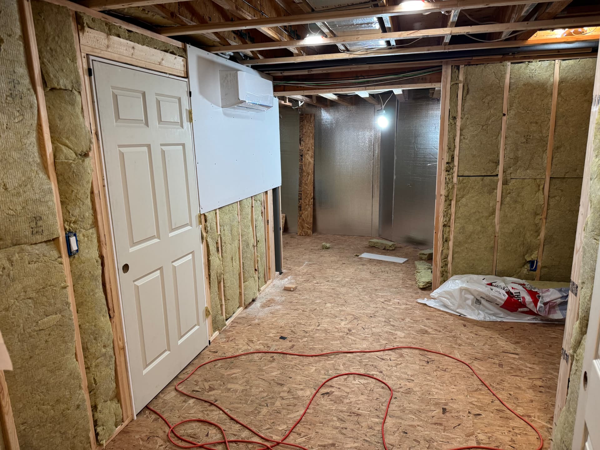

I see you have a mini-split unit for heating/AC in there. Did you ever look at a passive "dead vent) system where you share the air from another room to condition the air of your listening area? Or maybe you’re lucky enough to live in an area where you can “pre-run” the mini-split before listening and it will hold its temp long enough? I live in the southern USA, and even though my room is mostly below ground, I need a little heat and air for comfort. It was work and expense, but I can turn my vent on and have to turn it up pretty high before I can hear anything at all.
In my previous house I did an extension of the first floor zone to my room. It helped. But I did not want to pay for AC to be on for 1100sqft to only “help” the room that really needed it. So I added a minisplit there. that was walk out basement. super easy. 3" hole in wall and I had a 20amp source right there.
But this new construction, I wanted it done right from the start. Dont need much heat in that room, but I have new office right next door. so I put in 2 zone minisplit. from the construction pics you can see you have to run and hang the unit before all construction done. its a weird process. But I did the MRCool DIY. I would not do that again. No rebate with DIY, so all the money I save by doing it myself, I lost on rebate. Anyway, it works like a champ. only on when I need it. Fast cooling and heating (in New England we need our heat).
With the room super insulated like it is, all the equipment heats the room up fast. Projector too. In winter don’t need heat after watching a movie that is for sure. But summer like now, oh boy I use that AC. its whisper quiet too.

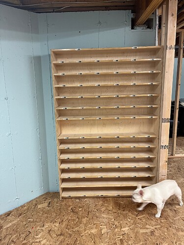

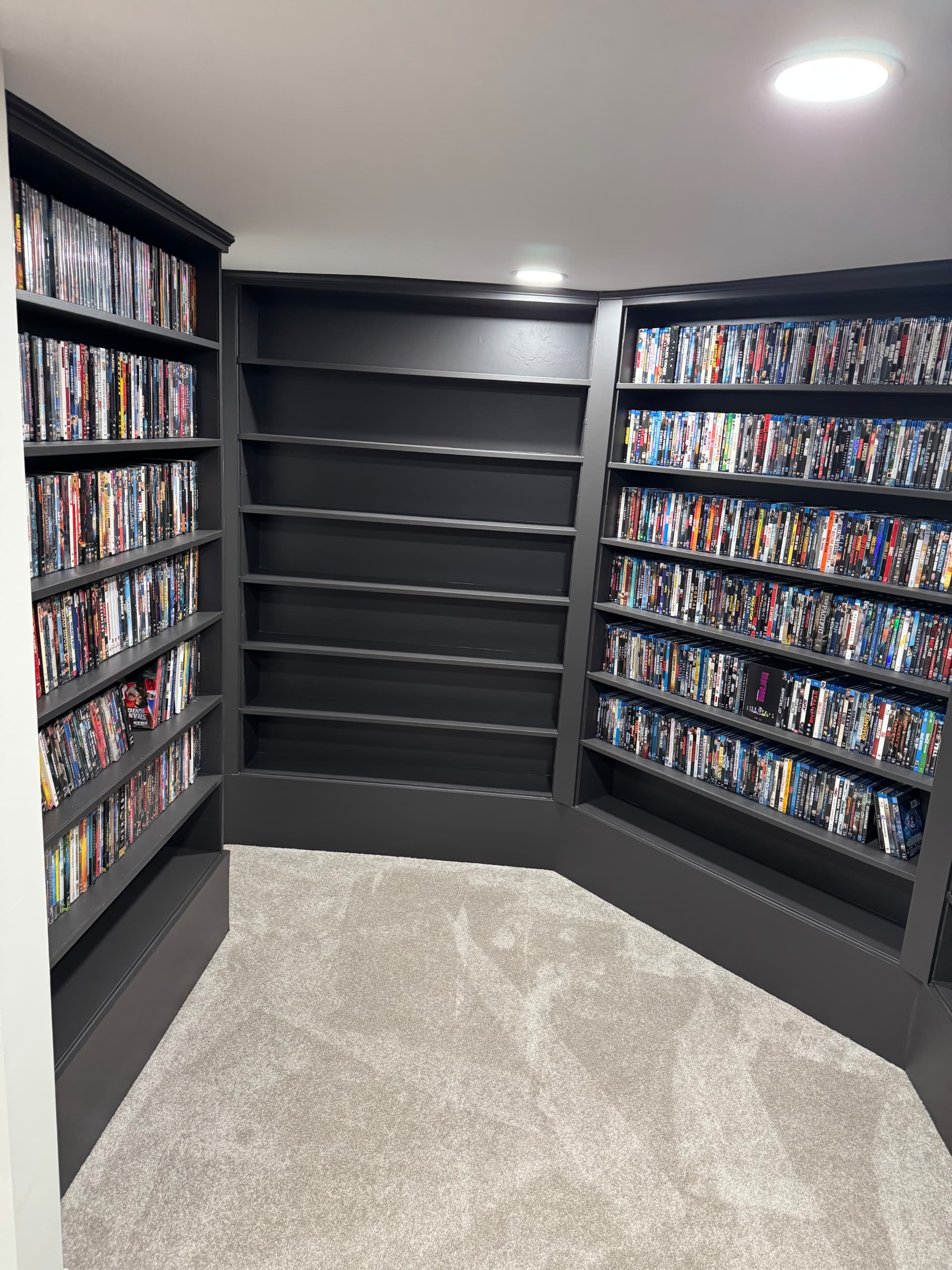

This is the office. You have to walk through to get to my music room. The room is below the family room which has a curved wall of windows. I found cheap home made shelves out of very good plywood on Facebook and had them mounted on that wall. Came out nice for my movie collection
I have to say, your finish carpentry is sure better than mine! But I inherited my talents from my father who, if it couldn’t be built out of 2x4s, somebody else would have to do it. But as I said, I’m visually impaired, so if someone comments on my shoddy woodwork, I have a great excuse. Now as far as SOUND is concerned, if that’s shoddy, the only excuse is budget.

Yeah I had help with that finish carpentry. If you see what they looked like when I got them, the. It’s really impressive. Got them for $20 each and modified them and had the carpenter mount and trim out. I did some of the easy face trim but he is the hard stuff.
