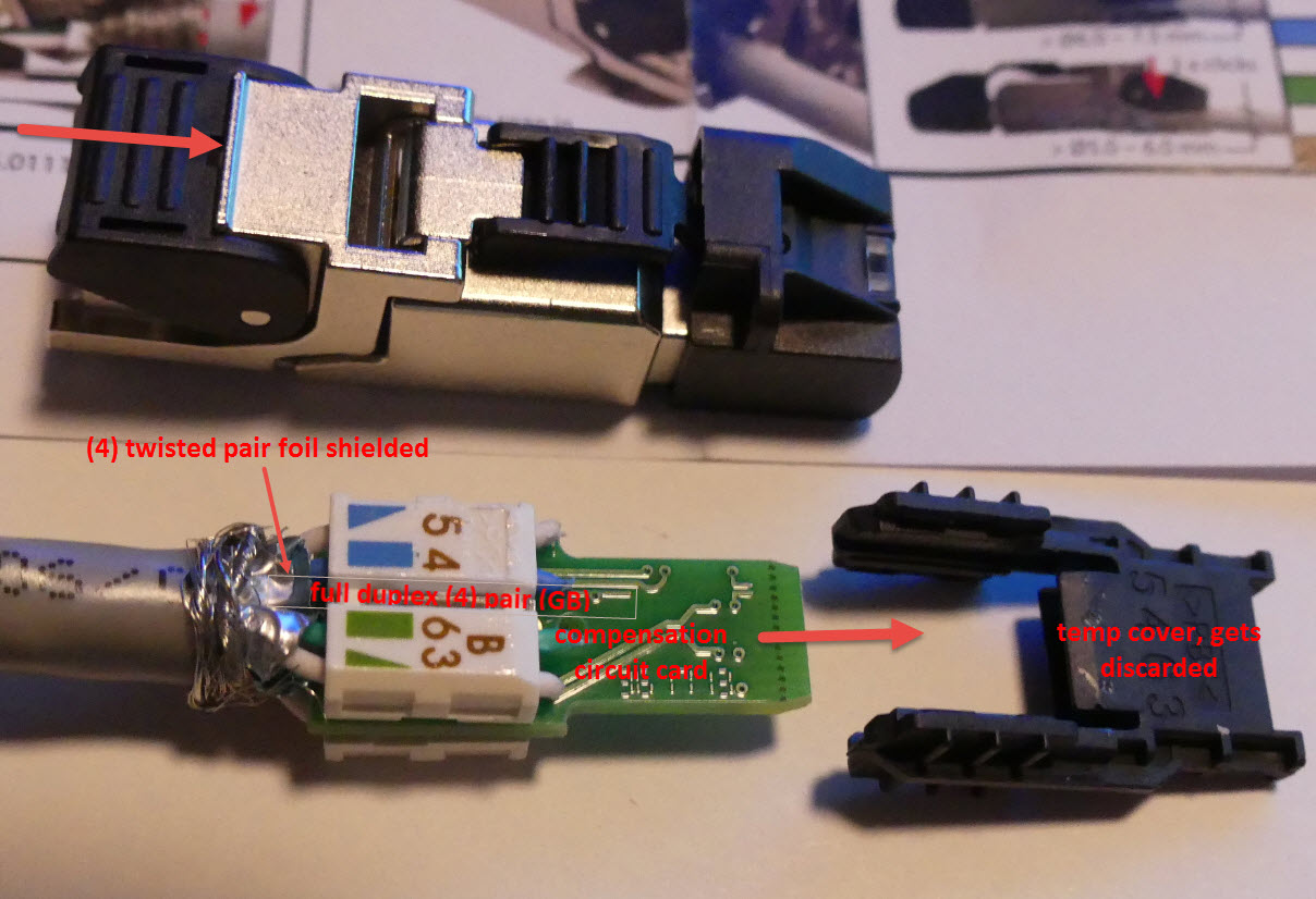

Telegartner J45 connectors
Here are the 25cm AQVOX CAT7 cables & Certicable w/ Talegartner connector use -
