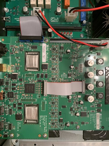

I opened up the DAC:

Can you tell what transformers are in the DAC? They look like the Edcors to me based on pictures I’ve seen. However, I don’t know what JK’s transformers look like.
The other part of the story is I already had a DSD MkI with upgraded Jensen transformers I bought here. The transformers came from JK as I understand. My plan is to build one DAC with the better parts from the two DACs. I can’t listen to know which is better because the Jensen transformers have less than 10 hours on them.
from photo it seems like upgraded with Edcor X4400 xformers (stock in MK2) and i don’t see other modifications on boards but I don’t know them all :slight_smile:
edit - now i notice some labeled black pads under the boards - maybe some form of shielding/vibration treatment?
Thanks for your reply. There is dynamat applied to various parts of the case, on top of the PSU heat sinks and between the metal and wood layers of the top cover. There’s also a strip of what might be EMI shielding along the rear edge of the cover.
My conclusion so far is Jeff R’s power controller board and the Edcors are the worthy upgrades, but the particular external PSU is nothing special. Where would I look for Jeff’s vcom mod?
