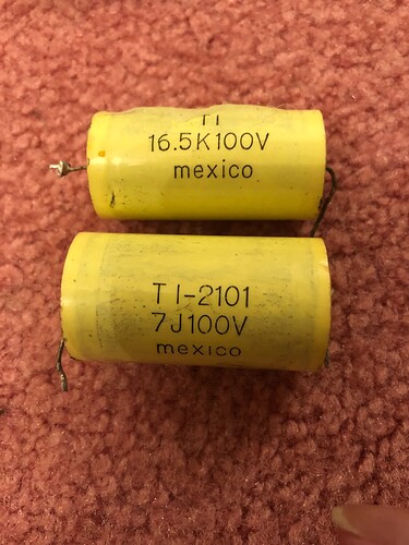

The caps in the crossovers makes a night and day difference in sound because they are directly in the signal path. I upgraded the old stock caps…
…with These…
…and all the fogs and veils vanished and all you hear is resolution!
Don’t take these hi end caps too lightly.

Not taking the signal path caps lightly.
Unfortunately I could not fit the ten-pack of parallel 10uf’s into the chassis after all! (And trying to solder in there was painful so the way to go is to have external crossovers…)
It’s about 200€/$ for a set of Jantzen Z-caps for all the caps in both of my Audio Physic crossovers so I better live with the lower output imbalance until I can afford a comprehensive set.
And have to say - it was not a pleasant surprise to see Audio Physic used really cheap electrolytics in a speaker that cost about 4k some 18 years ago. Well, all of that stuff in there is cheap! Intertechnik, but just cheap.
Why did you use ten 10uf’s? Why didn’t you use just one higher quality, higher voltage 100uf cap instead? It would sound better and save a lot of space.
Well, just as a temporary fix because I had a bunch of 10uf’s…
Yes, better do it properly, when I can afford it.
