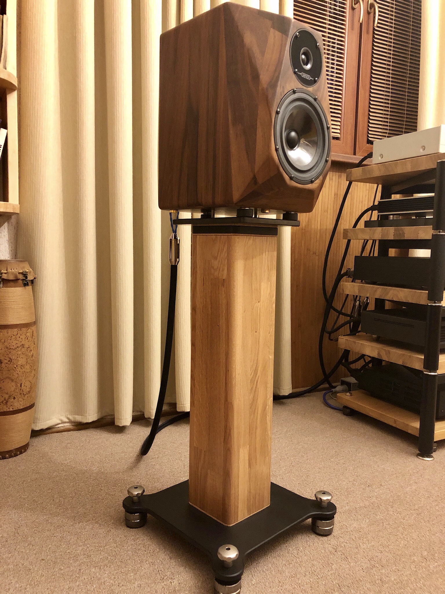

Those speakers look a bit like the Sonus Faber line. I really liked the craftsmanship in Sonus Faber speakers, and owned the Extremas for a while. -Very sorry I sold them.

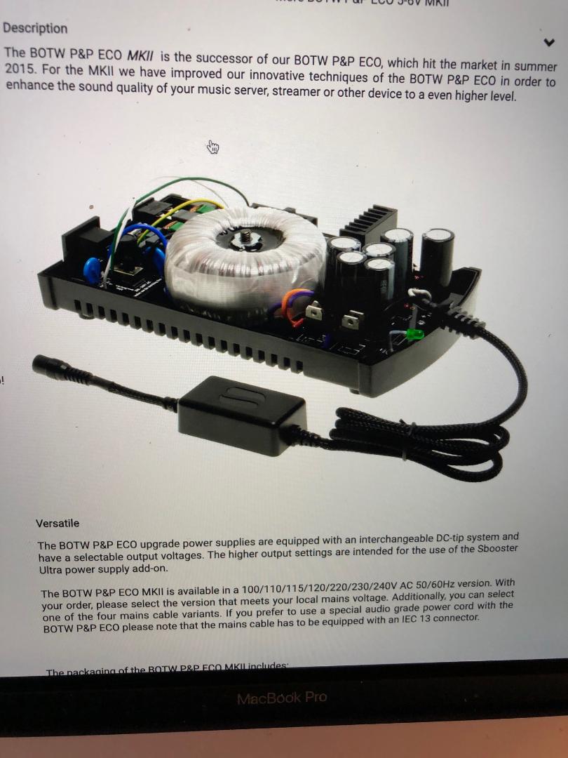

The N100H already runs on a decent linear PS, so the obvious question is whether one of the many outboard add-ons would make a big difference. The power solution waymanchen is using carries a cost of ~$625, over twice the cost of the Matrix itself.
do you have pics/specs of all this stuff?
Very interesting! :beers:

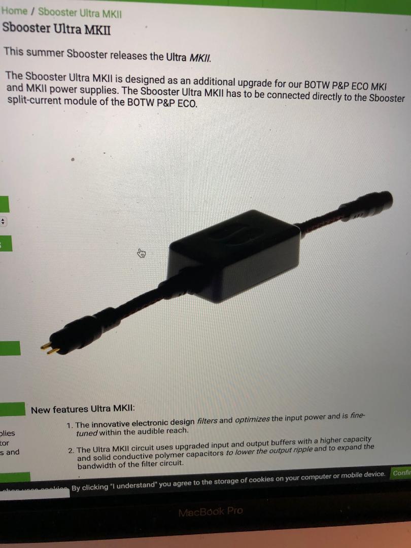

The Ultra is an add on filter. It makes a very good sound a little better. So does the SR Orange fuse. You just remove the cover of the Sbooster and change it, very easy. The size is small 5x20mm T250v 630 mA. The 5-6v Sbooster is $359. The Ultra about $100. The fuse $159. Together they make a formidable combination.
In fact I had Sonus Faber Minima Amator just before Diapasons. Both good speakers, but Diapason Adamantes has “bigger” sound. Not easy to capture how beautiful they are without proper light indoors. But they sounds as good as they looks:-)
Here is the Sbooster open while I was changing the fuse. Very easy to change. Also, the Ultra drops 1.0V so make sure you take that into consideration. In addition, adding the Ultra makes great even better.
