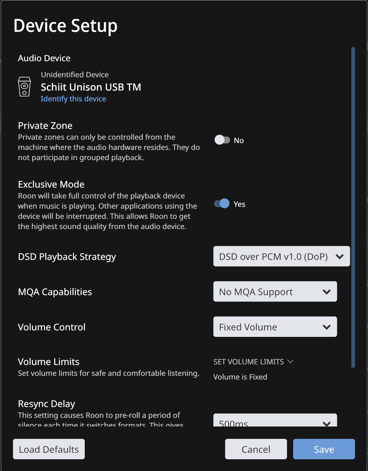

Under “Device Setup” for the zone, do you have “DSD Playback Strategy” set to “DSD over PCM v1.0 (DOP)”?

I really appreciate all the help everyone! I am using a Mac mini and Roon. I did set Roon to DSD over PCM. I am playing files that end .dsf and m4a. My albums are all in the range mr-ryan-eickmeyer specified. Is there anything I need to configure on my Mac?
