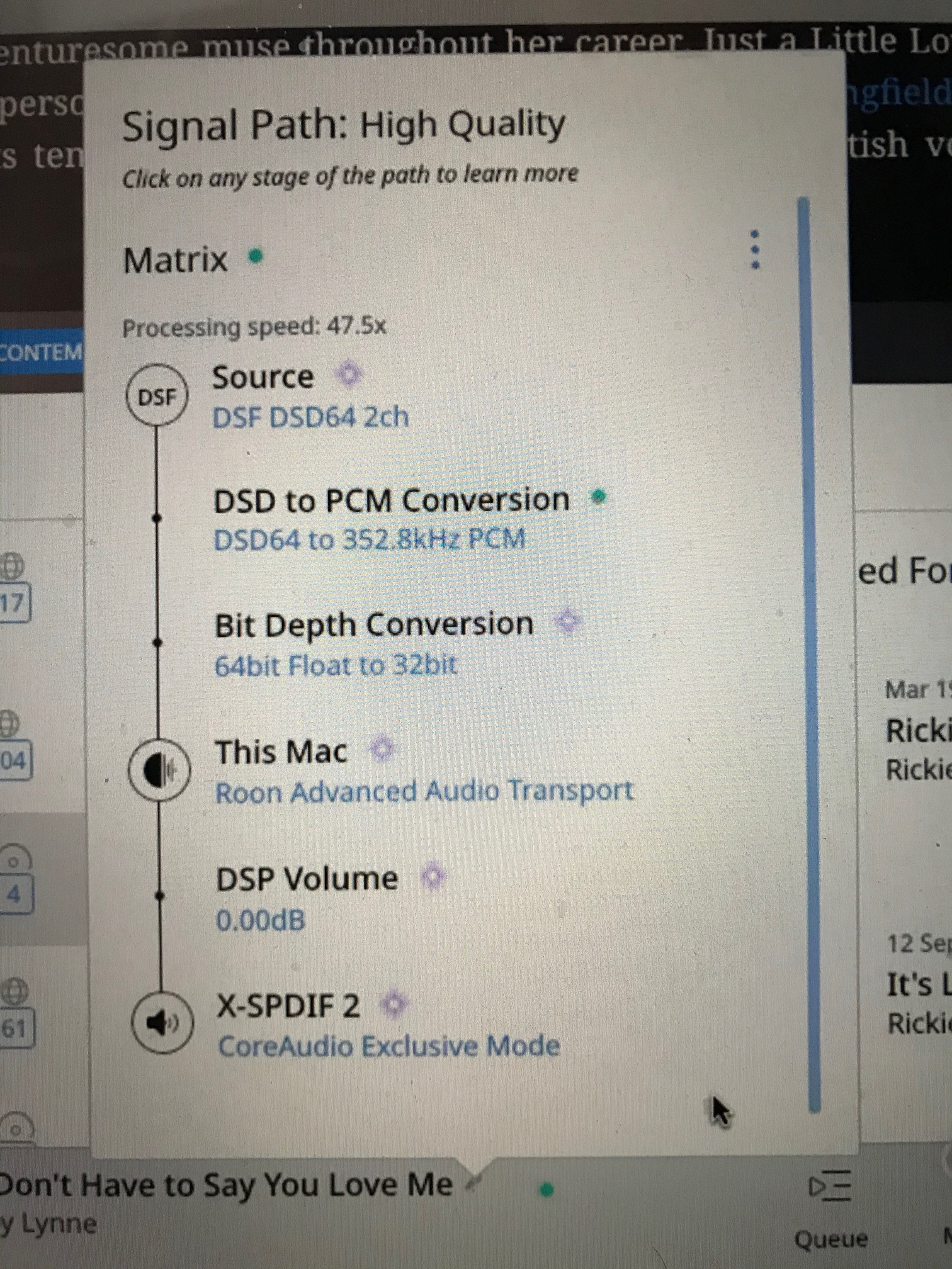

Could you post a screenshot of your signal path while playing a DSD file? The signal path is shown when you click on that (blue) dot in the play bar. Also Screenshots from the Audio configuration menu might help.
Thank you Philipp_Schaefer! Here is a picture of my signal path.

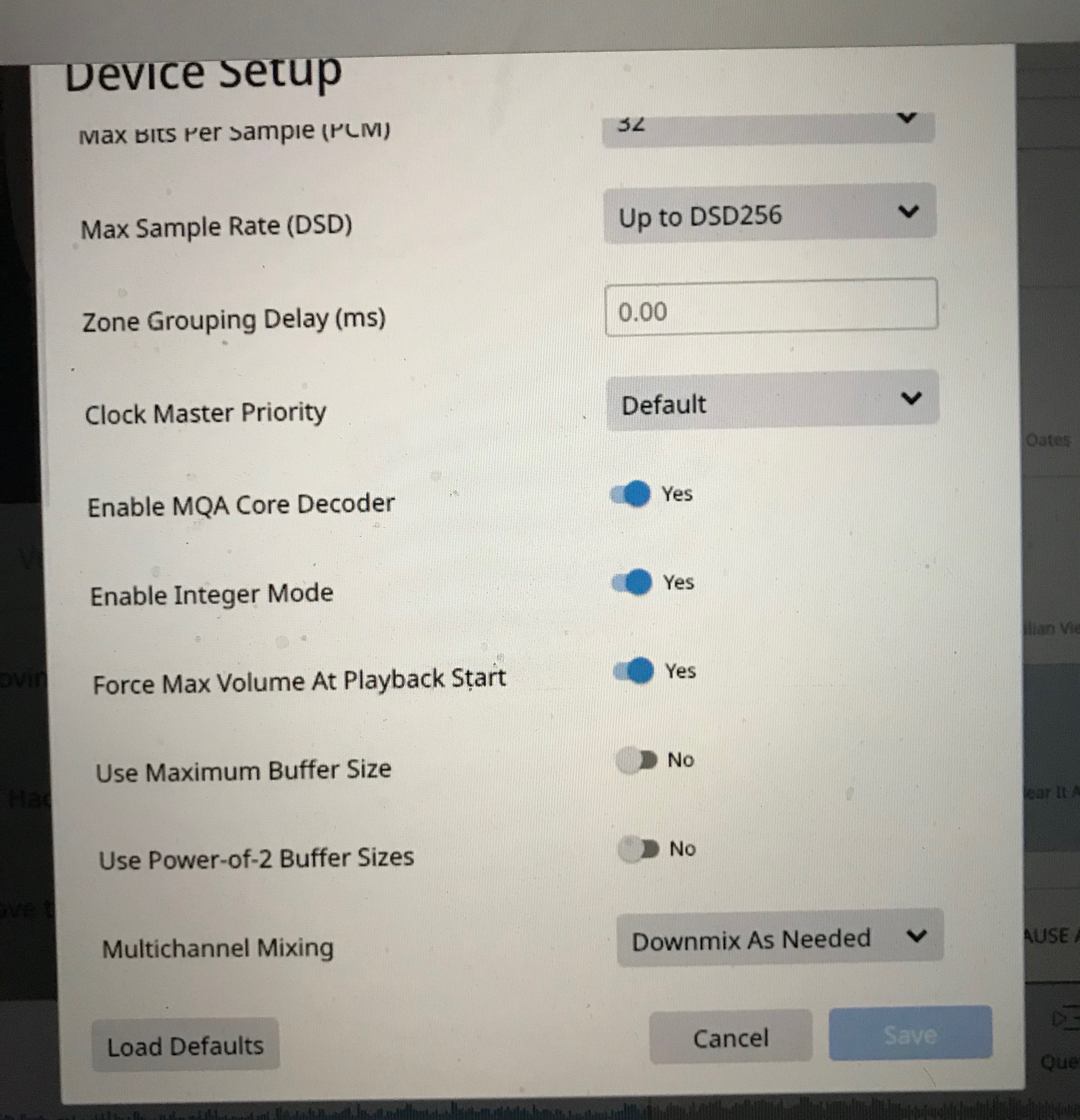

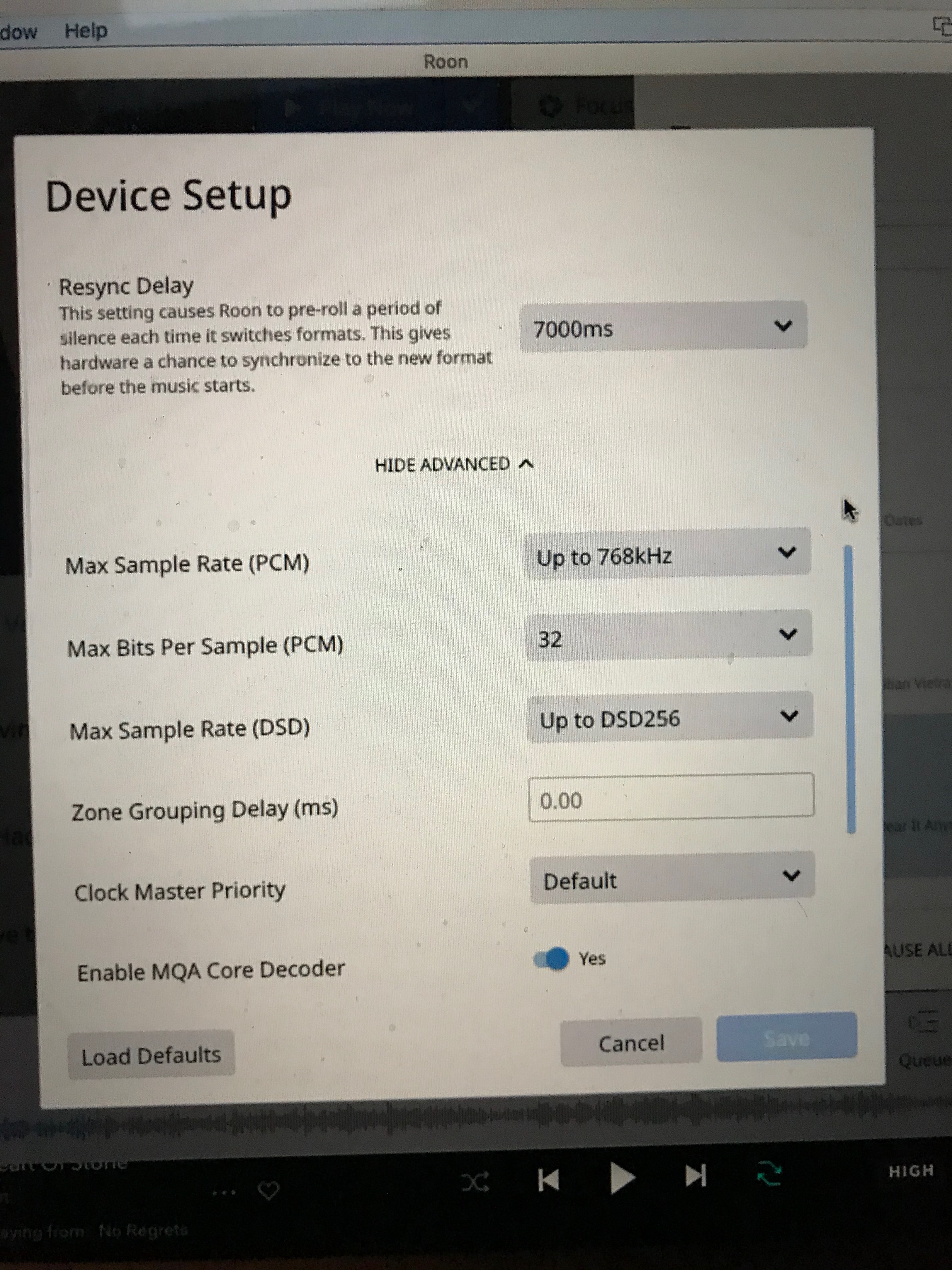

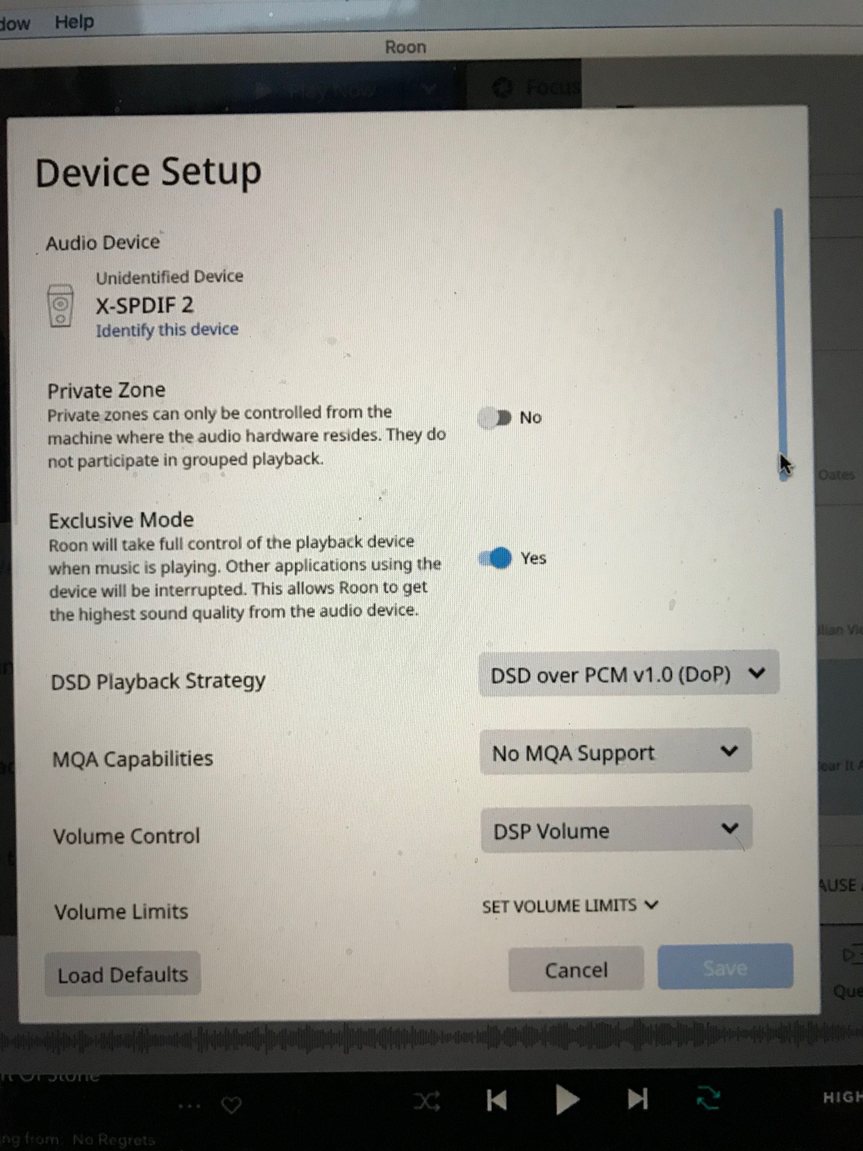

Here is how Roon is configured for the Matrix. Thanks!
Well I really don’t know your setup but doesn’t the DSD to PCM conversion spit it out PCM?

Volume Control set to “DSP Volume” is the problem. Set it to “Fixed Volume” or “Device Volume”.

Thank you speed-racer! When I set the volume control to “Fixed Volume” there is no sound. I only get sound when it is set to “DSP Volume”.
