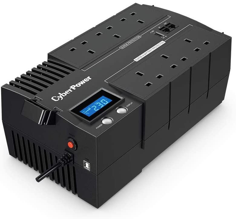

Although I usually get a ticking off from @elk when I talk about power supplies, because I use lots of different types, my NAS is powered by a uninterruptible power supply, along with my Mac Mini desktop and Innuos music server.
I’m currently using this one:
I had a music server that crashed and died following a power loss as the SQL database corrupted. It needed a factory reinstall except the factory had also crashed and died. I think it was connected to a Power Plant at the time, but loss of power is loss of power, unless it’s connected to a battery supply. I’ve used UPS’s for many years on anything computery.
