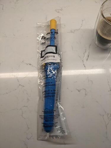

Edysn SOLDAPULLT
I purchased this one:
Tabiger Solder Wick & Desoldering Pump, Solder Sucker & Desoldering Wick, 2pcs Solder Braid (2.5mm Width, 1.5m Length)- Desoldering Vacuum Pump Solder Remover https://www.amazon.com/dp/B0777LMVTT/ref=cm_sw_r_apan_glt_fabc_XVBGKN1Y5Z0FMA7ZR8M8
I just ordered this one! I wish I had seen this a few months ago. I am pretty sure that’s the same model I used when I worked at Hughes a long, long time ago.
