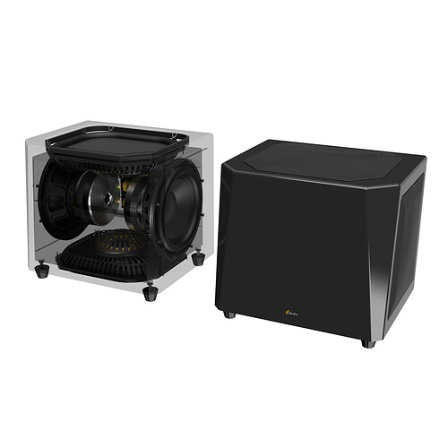

I’ll be changing the musicroom a bit the next month or two.. The two book- and CD-cases are coming out of the front corners and moving to the rear on the sidewalls, while the amps and CC speaker are moving about three feet forward and closer to the front wall; the loboy is departing the premises.(1) Then we’ll cut away the front six feet of so of carpet and level the front five feet of concrete floor.. All that will leave plenty of room in the front for a 3cm granite pad which will hold two or maybe three pairs of poweramps and somehow, the incoming ET LFT-12(new) CC speaker.. The angled corners will have plenty of room for my pair of GoldenEar SuperSub XXLs…
…which I’ll tune as real subwoofers that will be low-pass filtered at 40 or 50Hz, to reinforce and extend bottom-octave energy.
