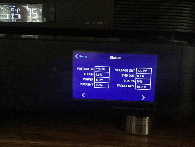

This is my P12 with Readings from the United States, California.
Those THD numbers you’re posting are quite large. Where are you located?

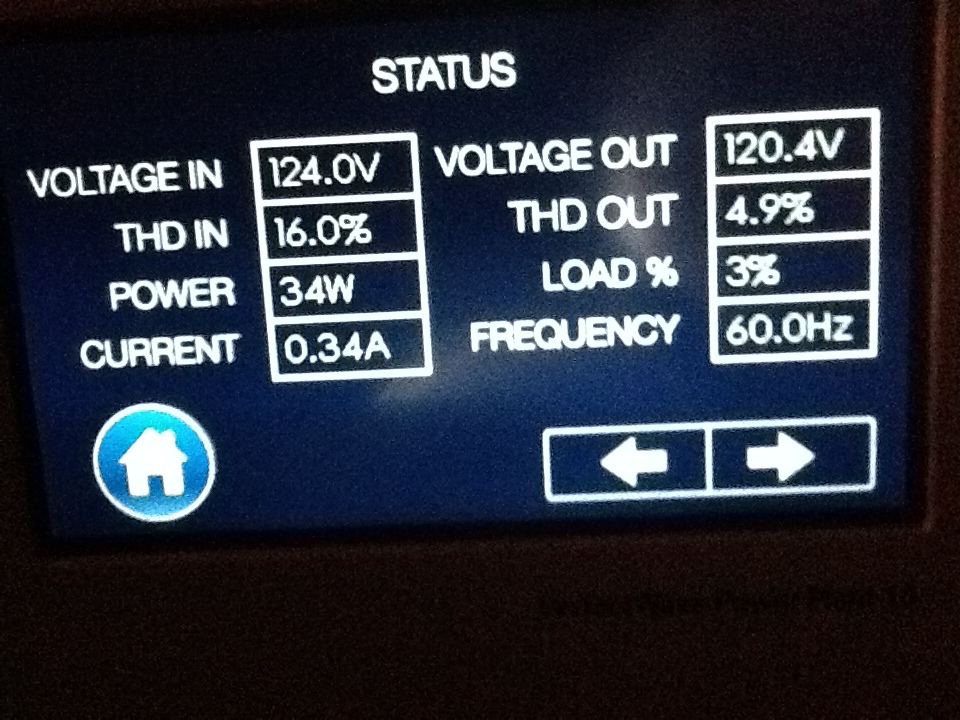

If you want to see really bad power, this is what I had years ago.
The P10 could not repair it completely. This led to the phase adjust that was added to the P10 to make it work under these extreme conditions.

st50maint - thank you for sharing that picture. Wow, I though I had it bad

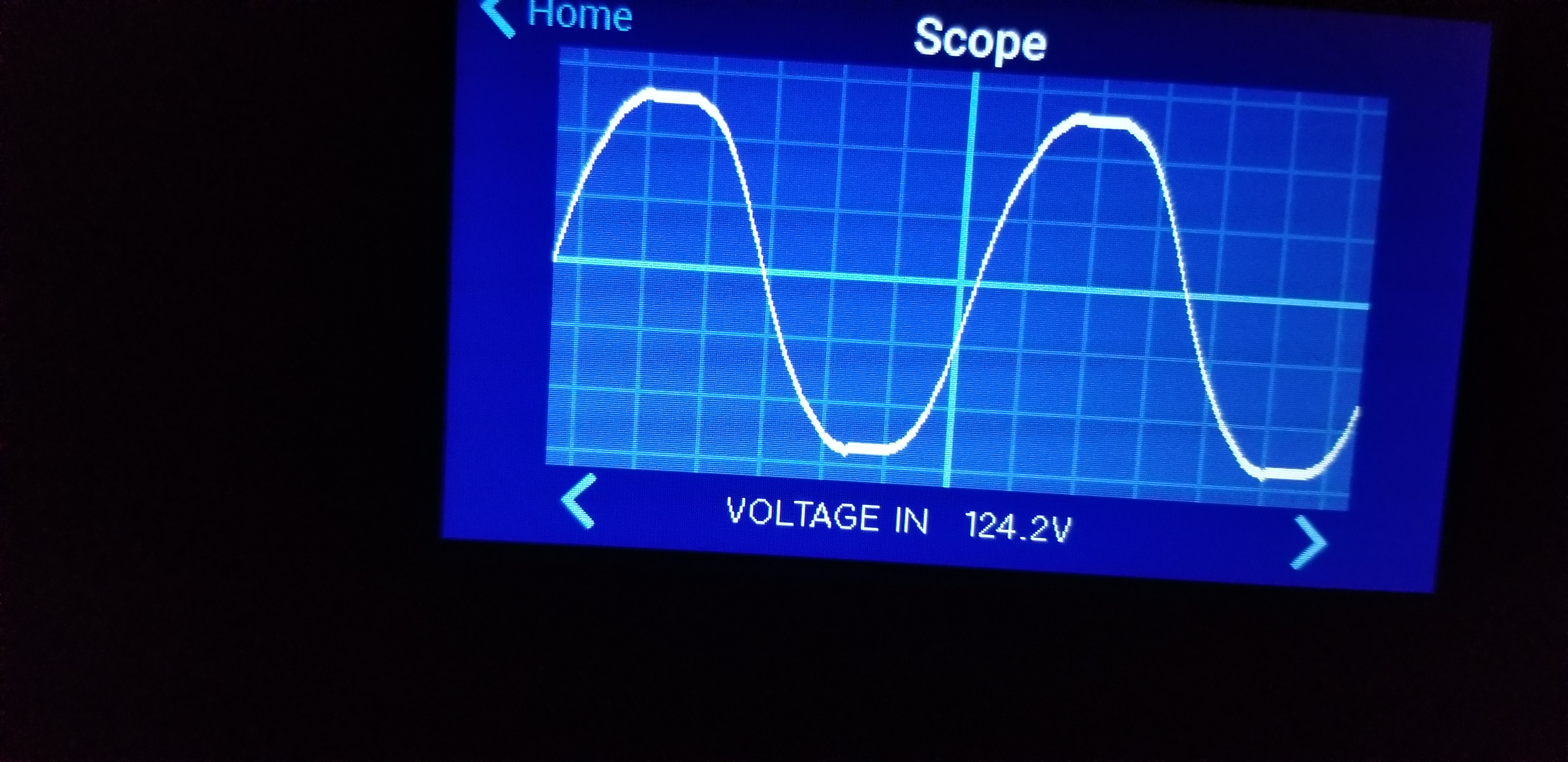

One request, if you don’t mind a bit of homework - could you post a picture of the incoming sine wave during the evening strafing event? It might offer us some clue as to what is going on.
Hi Schroedster - OK this is not exactly what you asked for since the issue is not happening tonight. The PP12 has held its own all night against a reading of 7.5% THD IN (7.5 is a new THD IN high for me). Nonetheless my sound system sounds absolutely flawless this evening. I decided to send the screenshots anyway since they may be useful as baseline data.
