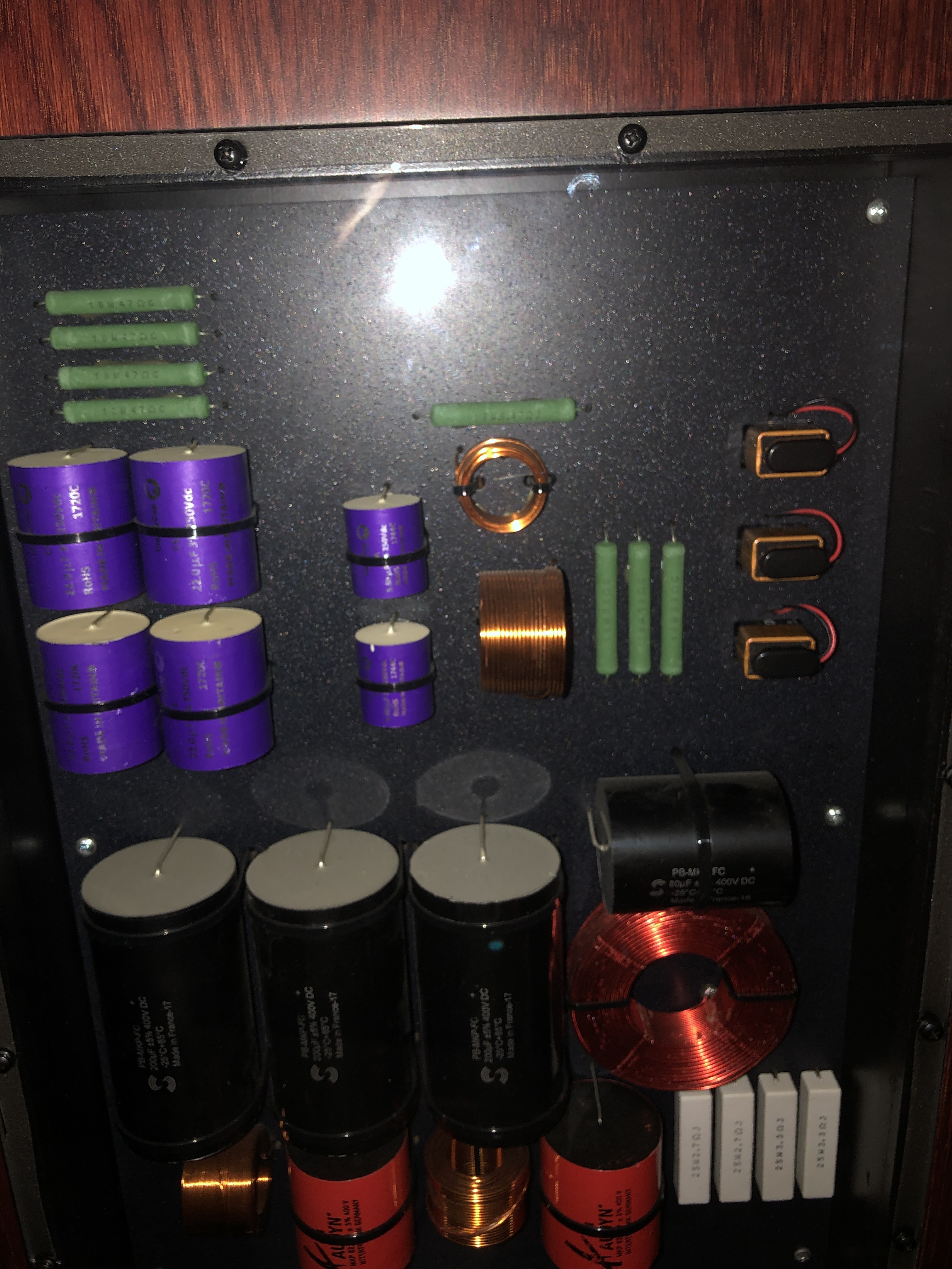

Nice crossover work :slight_smile:
If you share circuits, then please do, but of course if it’s your own proprietary design no worries!
Thanks. I’m not capable of something like that! Lol. It is Peter Noerbaek’s creation.
Crossover: 5th Order Charge coupled with 3 x 9V (27V) @ 900 Hz. 30dB/octave.
Well it’s a lovely job :slight_smile:
