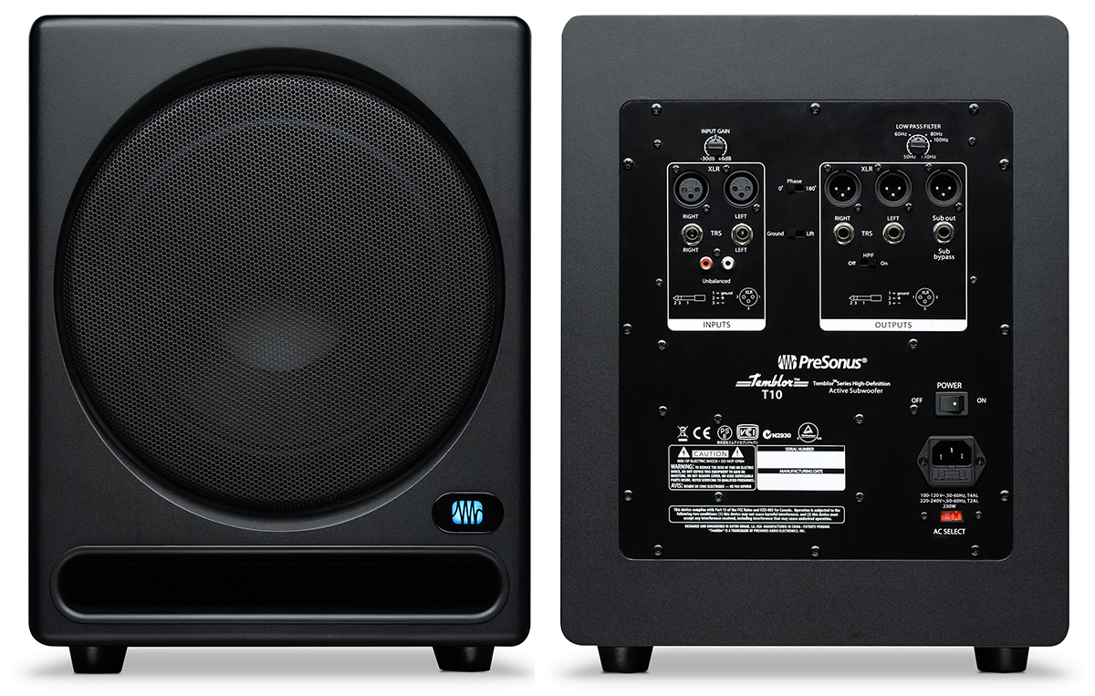

Just picked up two ($400) PreSonus T10 subs for my music system. Have XLR, TRS, and RCA inputs; XLR and TRS outputs; plus a XLR sub output. Ported but relatively small but work well.
Thanks, hadn’t heard of those. SQ aside, and I’m not able to pick up on that from the user reviews, it seems that there are a lot of manufacturing and/or design quality issues and not a lot of friendly customer support from PreSonus. May pay to get the extended warranty, although not sure if that helps with having to pay shipping both directions.
Compared to PS Audio (or I suppose ATC) support would probably be inferior. Being professional not a lot of handholding should be expected. Not sure where you’re picking up on manufacturing/design issues. They are ported (nearly all professional subs are). I ordered through Sweetwater and had a very good experience (were willing to have them to me in one day, but I asked to delay for 6 days which they did and kept me informed every step of the way).
More expensive professional subs are available if you want XLR pass-through.
I did a little review searching and found them loved at Sweetwater, not as much at Amazon, for example. I read critically (which also means not believing everyone who complains - or who everyone lauds). What I didn’t find is one independent review; one user who stated that they were using it with full range speakers; or one user indicating that they are used with any serious audiophile living room style systems. Every review I’ve seen so far is small, near field, most mid to low end models. If there are some that are different, they aren’t saying so. Two other drawbacks: gain goes down to only -30 db (vs. e.g., mute), which can be a problem in set up, and crossover only down to 50 Hz, which limits integration with larger main speakers, as I have. Also, I prefer sealed speakers, such as the JL Audio e-110’s I have (but haven’t set up yet). I wouldn’t mind a pair to try out, but might need more than 30 days. Hope they work out well for you.
