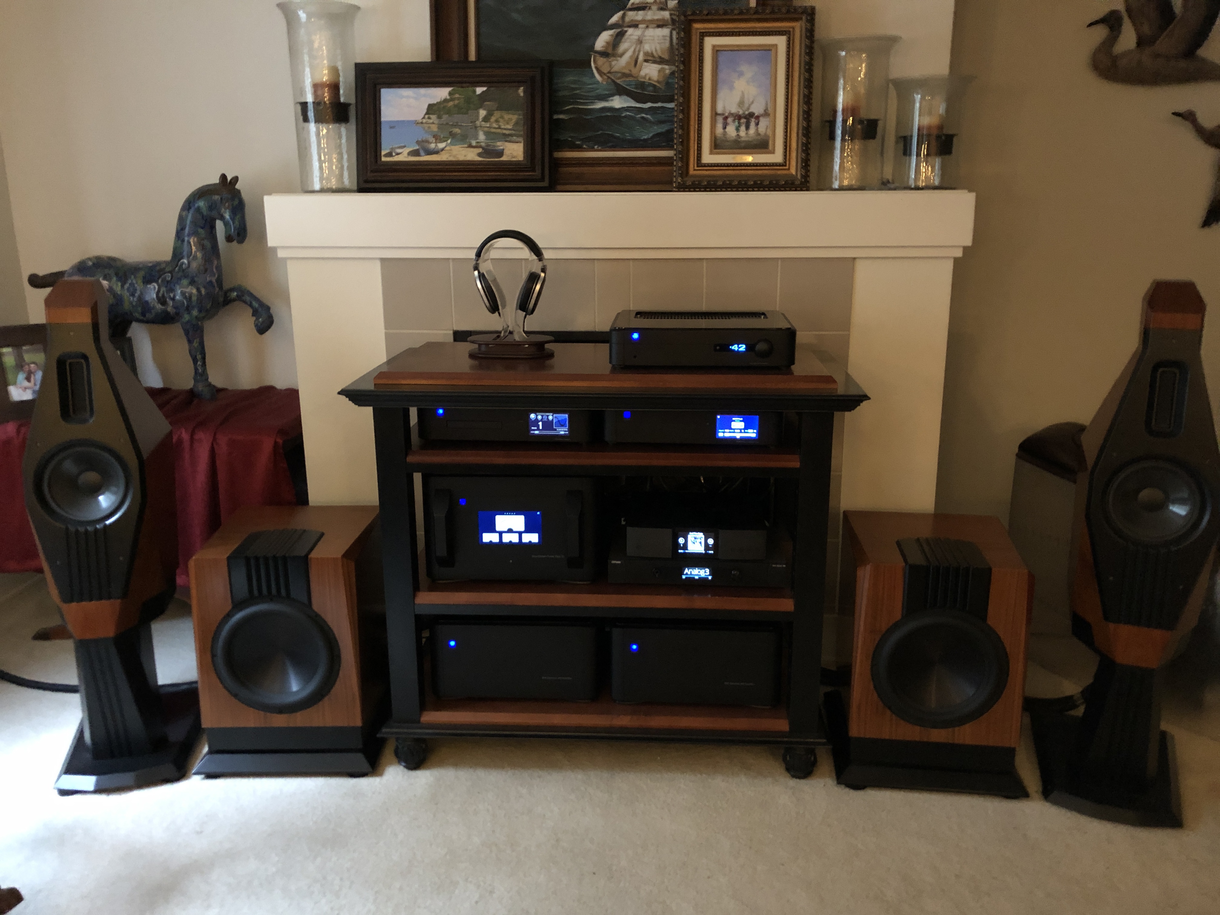

From your setup image, bass from each woofer/subwoofer will propagate in phase, magnifying the in-room bass node phenomenon: visualize a bathtub filled with 4 inches of water where you move your hand back and forth through the water from end to end; the waves move to the end of the tub and bounce back until they meet the next wave where they will cancel, double the wave height, or something in between; this is exactly how bass waves behave in-room. Note that where the dips and peaks occur varies with location and frequency. DSP can only correct for a single location.
Putting all the bass generators side-by-side multiples the effect. Best to randomly stagger them around the room. I have (3) subs: one about 12" from front left corner; one about 48" from front right corner along the side wall; and one roughly 2/3rd’s the way back along the left side wall. My monitors are 56" from the front wall and 36" from the side walls in my 8ft x 13ft x 21ft room (Fibonacci ratios). Read Floyd Toole’s “Sound Reproduction” 3rd edition.

Thanks for your comments. I am somewhat space and placement limited so currently my system functions like a 2.1 with full range floor standers, with a third sub halfway down the left wall. To the right the space opens up to a stairwell, then a pony wall, then even further back another alcove. I do use DSP for my listening location. I’m planning to relocate in two years to a new home with a dedicated room. My intent is to add two more subs at that time.
