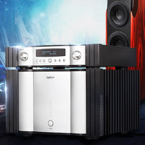

@Paul this I believe is his company - I have noticed he added an extra A to his name in the about section, but reviews on site have it spelled correctly.
I’m not saying tonewinner is bad, as I think they are a major OEM supplier.
