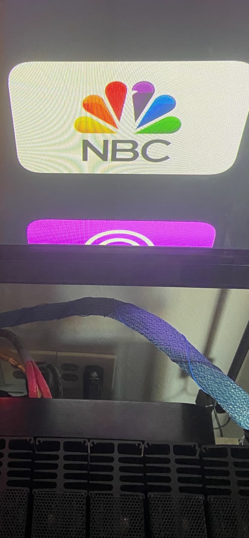

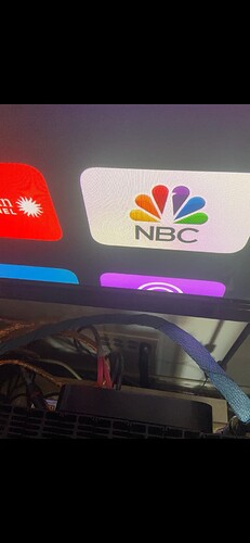

First picture only P20 plugged into a10 gauge dedicated 20 amp outlet by AQ Dragon HC powering plasma TV. Note square pixels
Second picture
Plasma TV plugged into another 10 gauge 20 amp outlet on its own circuit breaker.
You can see it plugged into wall under amp cables
Look at NBC peacock waves in white field clearly noise.
Any questions?
The camera clearly has moved position between the two pictures. That is aliasing between the camera pixel grid and the TV pixel grid.
Put the camera on a tripod, adjust to kill the aliasing, then re-take the two pictures without disturbing the camera position.

So the pixelization difference washed out the colors too. Fools my eyes from across the room. Amazing the ends you will go to.

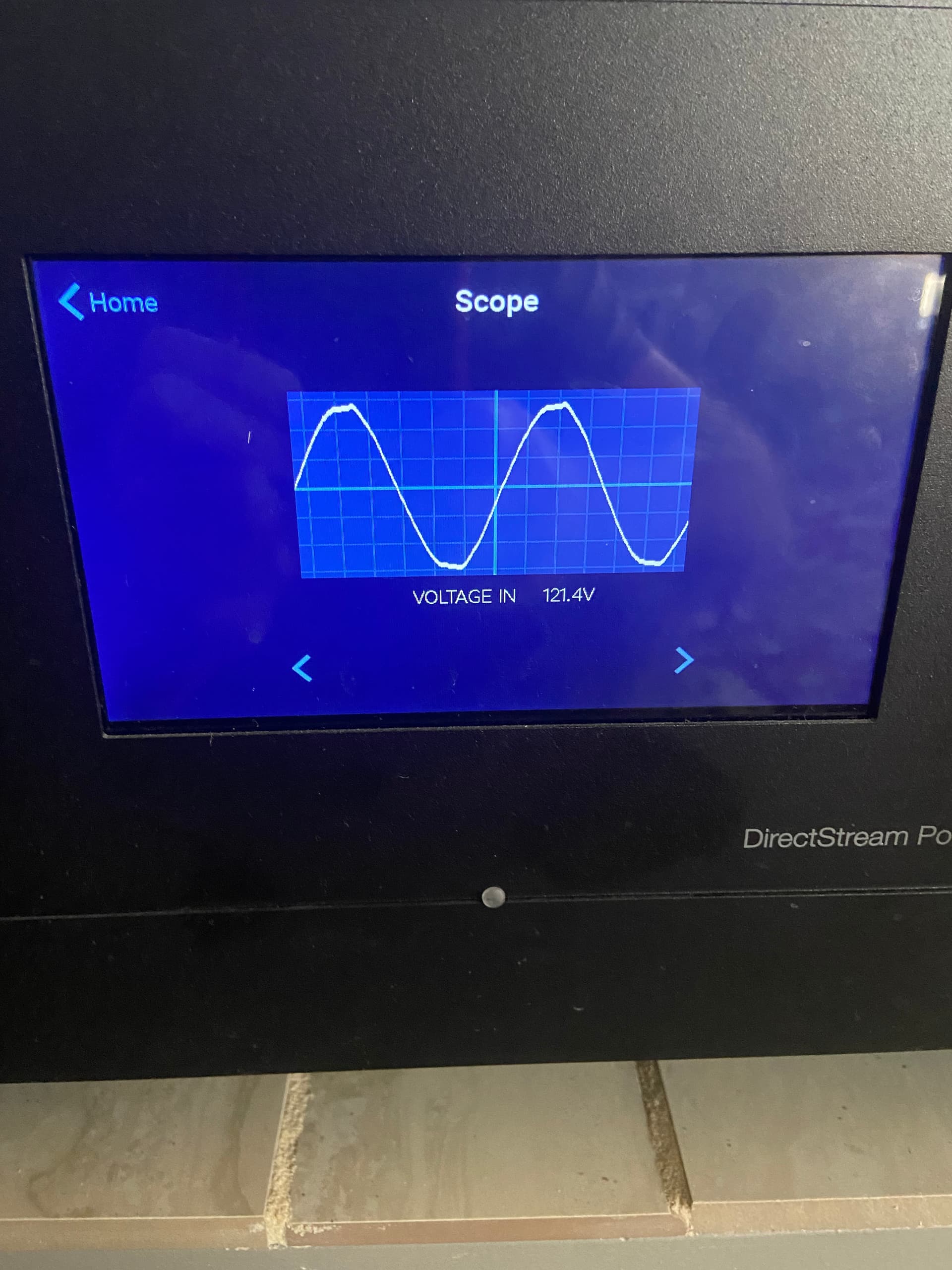

Might like to post pics of the screen from your regenerator
showing thd % in and regenerated power with the much lower thd.
There is no rebutting that
