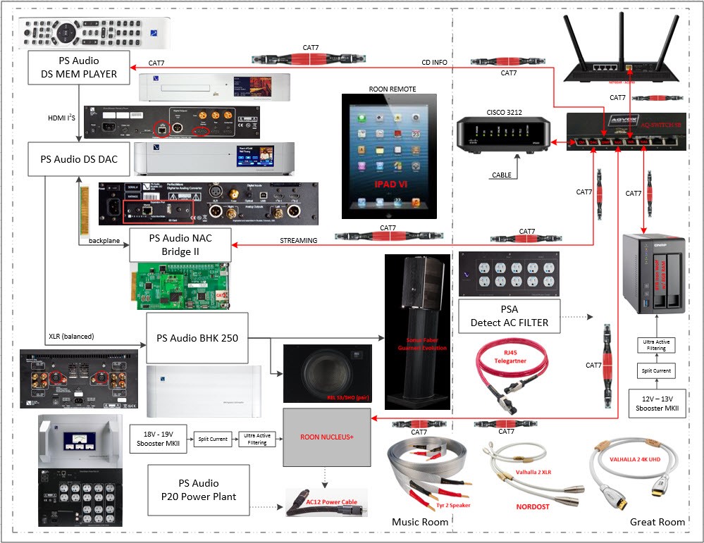

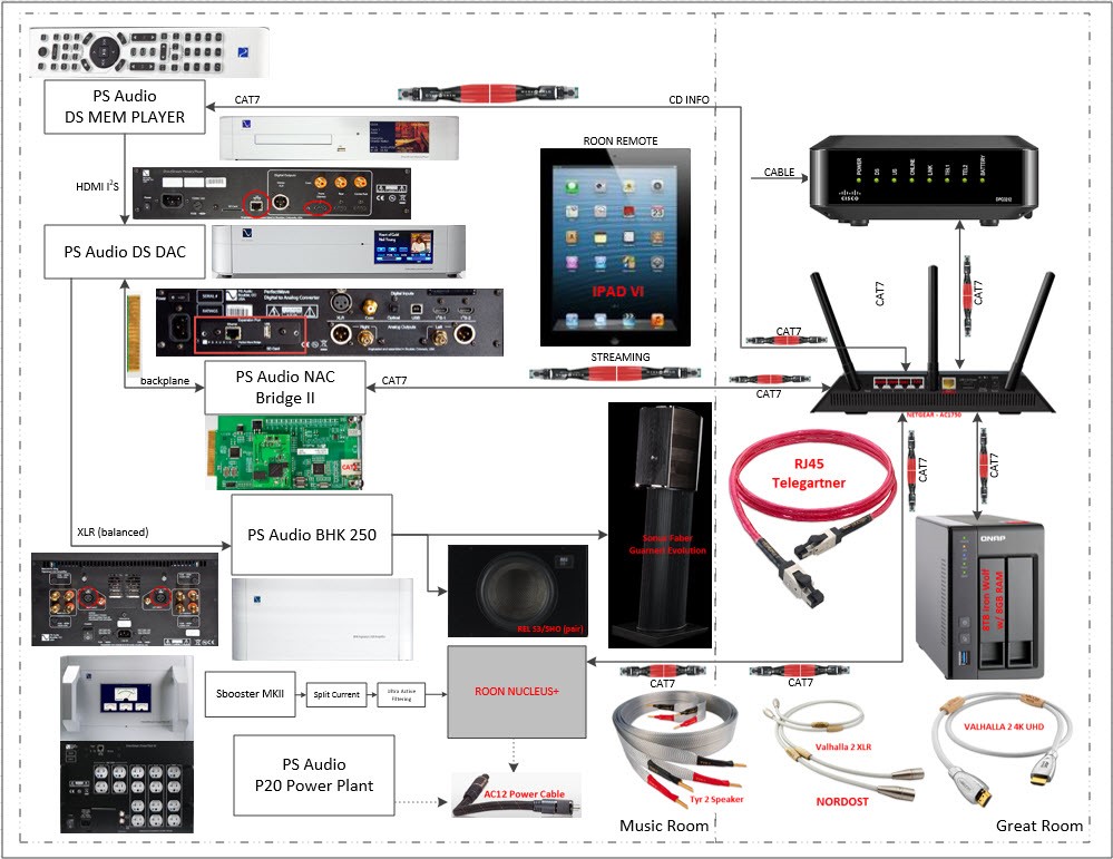

@bootzilla - I was using Mconnect for the first (5) months after I initially put my system together in April, 2018; not sure how I wanted to run my system. I set it up with (3) CAT 7 (great shielding) cables from the great room to the music room and terminated them myself with Talegartner connections for all Ethernet ends, including the cable modem to wireless router. Initially I ran Mconnect for the first months and acoustically it seemed great; however, nothing to compare. I just went to Roon Nucleus+ w/ Sbooster Ultra LPS plugged into the PSA P20 to use convolution filtering. Holy crap, what a step up from Mconnect on so many levels. Sound is amazing, meta-data collection & organizing is amazing, speed jumping from present listening to something else is flawless, fast & smooth. On a scale of 1:10, Mconnect is a 1 and Roon Nucleus+ is a 10. However, I have nothing to compare. I made sure the Ethernet cabling and connections were the best shielding and connectors I could buy. Below is my block diagram. This configuration is the best sounding & best functioning I have experienced to date. I can’t wait for the PSA DS Sr DAC update in a few weeks. Maybe I am lucky with PSA gear; however, I don’t see issues with anything and I’m running all PSA gear… Also, Roon Nucleus+ took me 30 minutes to set up, it was so, low drama.

@apogeestage - After researching adding the GB ENET switch between the cable modem and wireless router, it looks like I can’t approach it this way. It looks like the switch has to be after the router. Need to look at this in more detail.

Connect your cable modem to the WAN port of your wireless router, connect the GB Enet switch to a LAN port on the wireless router, connect all of your CAT7 local connections to the GB Enet switch.

@drybeveridge730 - Yes, BD below. Then why add the switch if I have the Ethernet connections and it works fine. There lies the rub. After reading the AQVOX literature and reviews on the AQVOX SE GB ENET switch, it will reduce the noise floor and add a lot of detail. My PSA DAC and Roon Nucleus+ is sitting 100ft (CAT7 cable) through attic. This switch will help as a buffer, jitter, and noise rejection… For close to $1,000 it would be a big leap in hope… However, if you consider an Sbooster "Ultra MKII is $500 and the AQVOX has the PS figured out…
2%20CH%20Block%20Diagram%2008
@apogeestage - never entered my mind; however, an approach many use. I just had my Ethernet infrastructure in place and went the Starred topology w/ wireless router are the tie point for all Ethernet connection. I could go SSD attached to Nucleus+; however, was warned not to go that way. However, never delved into why not… had the infrastructure in place already.
