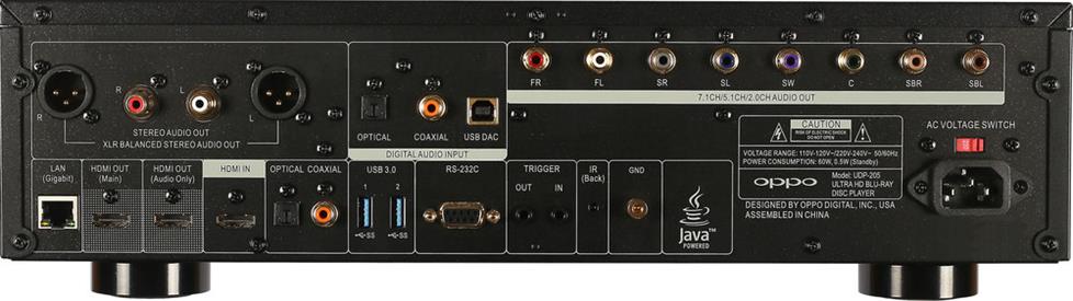

Let’s break all of this down. Here’s the back of the 205:
“One Oppo DAC outputs XLR for the FL & FR speakers.”
To be clear, the XLR output on the 205 are always stereo outputs, which means that if you’re playing 5.1, these stereo outputs are a downmixed version of the 5.1 surround channel. (This seems to be exactly what you want to use the Altona device for).
“Another DAC outputs RCA for the same front speakers (full signal).”
yes, these outputs are non-mixed discreet channel outputs. So the information is different between these two analog output options when using a surround sound format.
“The XLR cables have an inline dividing network (capacitor). The stereo cables go to two subs. I want to leave the XLR cables in the DirectStream.”
So if I’m understanding you correctly you’re saying you’re going to only use the unbalanced RCA outputs that are next to the XLR outputs on the back of the 205, correct?
" In 205 settings, stereo will be set for two channel listening and the RCA stereo will go to the subs. For 7.1 the settings will change to FL and FR of the 7.1/5.1. Again the RCA stereo will go to the subs. "
So if I’m understanding you correctly, you’re saying that anytime you’re listening to a 2 channel audio format you will select the “Stereo Audio Output” in the settings. When you change to a 5.1 or 7.1 audio format do you plan on swapping the RCA cables from the “Stereo Audio Output” to the discreet FL and FR unbalanced outputs? Again, the signal will be different because one is mixed down to 2 channel and the others are discreet channel information.

My original goal was to primarily use the DS w/bridgeII as a stereo streamer of Tidal with MQA processing. My components are in a large cabinet with a 65" OLED on top. My 3.6 Magnepan speakers are amazing and I wanted to use them for both DS streaming duties as well as part of a full 7.1 Magnepan theater. Since the DS was already connected to the 3.6 amp I didn’t want to move the whole cabinet to reconnect the 3.6 amp to the 205 FL & FR speaker out of the 7.1 system. I wanted Atlona to allow DS to pre amp the FL & FR speakers.
I really appreciate your detailed step by step efforts to understand how the 205 and DS could work together. As I was going through your details and explaining the setting effects in the 205 of choosing “stereo downmix” or “FL & FR”, I realized I had made a major error with my sub connections. The 3.6 speakers are much more efficient if they don’t have to deal with very low frequencies. With speaker settings set to “large”, an engineer friend of mine helped me build an inline dividing network (a capacitor in the XLR cable) to cut off below 72hz. Then the full range stereo RCA cables went to two OB GR Research subs to fill out the bottom of the stereo signal. What I had overlooked until I went through all of your details was that I would also need to do the same thing with the cables from the DS. Unfortunately, I cannot use both of the DS XLR and the RCA cables since they are coupled. PS Audio says to use a Y connector for main speaker/sub use.
I now want to have two separate systems. I’m searching for a switching box so I can use the same amp and 3.6 speakers with subs for both stereo DS and separate Oppo 7.1. Any suggestions for a box that will switch two stereo XLR/RCA systems.

If you wish to operate a 2ch stereo system for music side-by-side with a multi-channel system for movies - and many of us do - the OPPO should be connected to a surround sound processor via HDMI, the OPPO coax output goes to the DS, the outputs of the SSP go to the amplifiers, the XLR output of the DS gets connected to XLR input of the SSP.
The SSP does the source switching between movie source and music source, and it looks after volume control for both. Again, you don’t need the DS. Instead you can connect the XLR stereo outputs of the OPPO to the SSP in-lieu of the DS, or of course the SSP can do everything you want - movies and music - by itself over the HDMI link to the OPPO.

I run the Oppo surround RCA preouts directly to their corresponding inputs on the Ultra. I run my DS DAC into the Ultra as a separate 2-Ch input. I simply turn the input selector knob on the Ultra and I can go from my DirectStream 2-Ch listening to 5.1 surround sound out of my Oppo UDP-205. The Ultra allows for 4 different 2-Ch inputs which accommodates my turntable and reel-to-reel tape rig as well.
Now, the only caveat is the Ultra supports 5.1, not 7.1. But not a big deal. You would just run the two side channel surround RCAs from the Oppo out directly to the amp powering those speakers, bypassing the Ultra preamp. That amp would control the volume for those two particular surround speakers instead of the Ultra.
