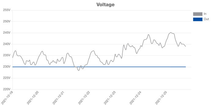

I own P15, which may or may not be different in terms of handling voltage fluctuations.
So please bear with me as I relay my personal experience. I bought the P15 because my Dectet would trip a few times a day. After installing the P15, I realised how wild my incoming voltage was. Depending on time of the day, and time of the year, I was getting anythign from 223 all the way upto 240+ volts. My P15 never ceased delivering since October 2019. Below is a sample around Xmas time.
