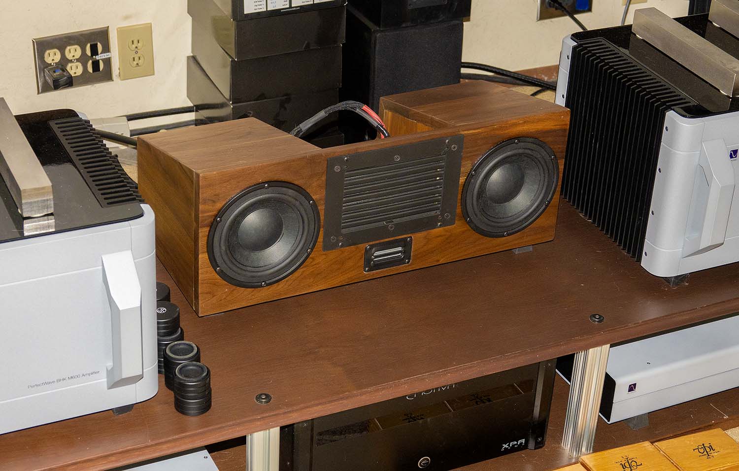

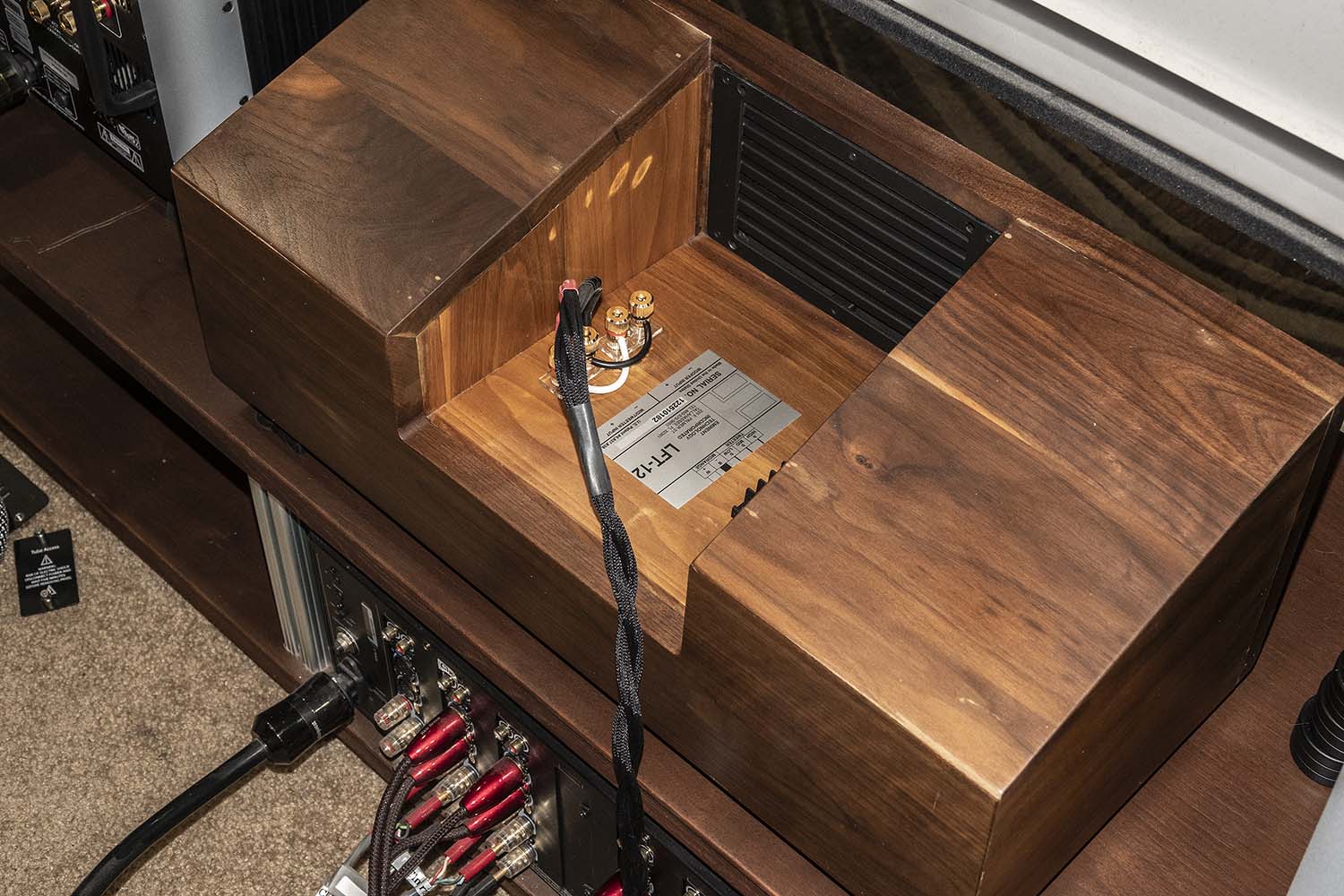

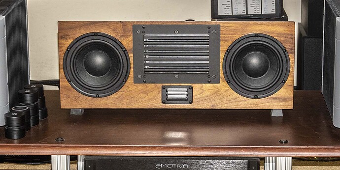

FWIW, here are 3 pics of my new/old LFT-12B centerchannel speaker, made of solid-3/4” walnut panels.
