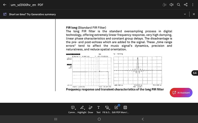

Be realistic, DSD isn’t the be all to end all. The signal is STILL going through FILTERS with critical damping at different places. The end result is largely how well you like the sound of the filters be it PCM or DSD. Also, the DSP, like what is in the JRiver 34 software, used to convert WAV, AIFF and the like to DSD512 have a sound too. Don’t neglect to listen to each signal path and see what’s best with your equipment. Most DAC’s have a few filters to try. DSD can have advantages BUT, the filters can outweigh those overall. Your ears will know. The impact of filters isn’t a secret science, either. It is well understood and why they sound the way they do. The secret is if your vendor provides the information. When you get to DSD512, you don’t have to stay there!
Galen
EXAMPLES from my T+A SD3100 HV DAC.

I also use Qobuz as native PCM to my DAC (still need to select the filter!). JRiver can DSP upsample PCM to DSD512. I find too much DSP hurts more than helps so I stick to what the SOURCE is NATIVE.
As you can see above, the SOUND of the plyback filters is different and ALSO, the sound of the encoding filters used to make the digital SOURCE are baked-in, too. You only get to choose the playback filters unless you use DSP, and pick the upsample properties, to upsample PCM to DSD, and pick that plyback filter so a lot to consider when you try to say what it sounds like. I’d say 50% of my native PCM or DSD can swap fidelity for these reason.
