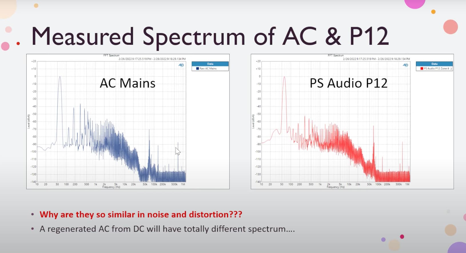

I only glanced at the doc, but I may be able to somewhat explains where the DC comes in. This may be where certain individuals are harping on the AC-DC-AC shtick.
Just from looking at the flow chart, the incoming AC is used as a basis to create a 5v peak to peak signal.
That 5v signal is used to generate a simulated, ‘corrected’ sine wave. The AC (in the US) is supposed to be 60Hz in frequency, but most times, it only gets close to that at best.
The “simulation” is likely via PWM (pulse width modulation) - without getting into the heavy stuff, it’s using a bunch of square waves, of varying widths, to represent what the 60Hz should ‘look’ like in a digital domain. This is where the ‘DC’ comes in. PWM signals, by nature, are DC signals (on/off of varying widths rather than positive/negative). The vast majority of inverters that do pure sine waves use PWM.
This now 5v PWM signal (DC) is used to reference to a 2.5v sinusoidal signal (analog/AC - 2.5v because half the 5v is being used as a reference for positive, the other half for negative) which is then further filtered, then amplified - much like how an analog amplifier takes the low level signal from your DAC or preamplifier and amplifies it even more to finally send to your speakers.
So the ‘DC’ part is not DC in the sense of positive/negative(ground), but more related to PWM, which is inherently more akin to DC than AC.
The power to do this amplification, by default, has to come from mains power, since it’s not a gas or propane powered inverter generator creating power via an internal combustion engine.

But doesn’t explain this slide from ASR’s video.
I’m a P12 owner, and I would love to see a PS Audio response to Amir’s data on the P12 not regenerating AC.
No, the P12 and all modern Power Plants are not traditional regenerators (which are 50% efficient). They regenerate and regulate the hot side of the AC line with a tracking power supply in an effort to improve efficiency (which is now about 85%).
Their purpose is to lower impedance, regulate the AC, regenerate a new low distortion sine wave, and (with MultiWave) extend the peak charging time of the waveform—and they perform these functions beautifully.
I think we’ve been pretty clear about all this since the inception of the Power Plants (their patented circuitry is readily available through Google patents).
As to why we didn’t use the fancy scope, I suppose I didn’t (and don’t) see what difference that would have made. Unless I am missing something, the front panel scope does quite a nice job of showing the differences. We weren’t trying to make this a big production or an answer to anything. I simply wanted to make an easy to understand video showing what the Power Plants do and hopefully what value that is.
