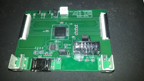

Fitted the Oppomod i2s output board today.
It works!
It used a Xilinx CPLD chip to do its thing.
No issue with reversed channels, all good.
Dont have any SACDs here to test yet, but DSD files from a USB key are sent properly to the directstream, and DSD is displayed on screen.
Sounds superb, redbook CDs sound far better via i2s than coax to the Dac.
Bluray movies too…wow.
Happy days. :slight_smile:

  • It’s not clear from the photo, but is that black piece an HDMI port?
  • Did you cut out the back of the 103, per the seller’s photo?
  • Anything else to know about fitting the board, such as how easily it attaches to the 203’s chassis - or does it attach to the back and sit in the air?

**It’s not clear from the photo, but is that black piece an HDMI port?**
If its the one on the PCB then no, its unused, HDMI port is on the back.
**Did you cut out the back of the 103, per the seller’s photo?**
Yes (Used a Dremel to cut gap to fit board)
**Anything else to know about fitting the board, such as how easily it attaches to the 203’s chassis - or does it attach to the back and sit in the air?**
Has 2 mounting points wither side of back of card, which connect through venting slots in back of Oppo and lock card to back panel.
(Mounting screws didn’t come with it, M3 machine screws work perfectly)
