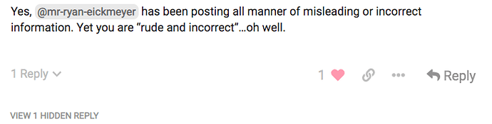

It is working on my end, Al. Ryan’s posts are hidden now, and I see a small notation indicating as much, with the option to unhide them. Here is one example:
