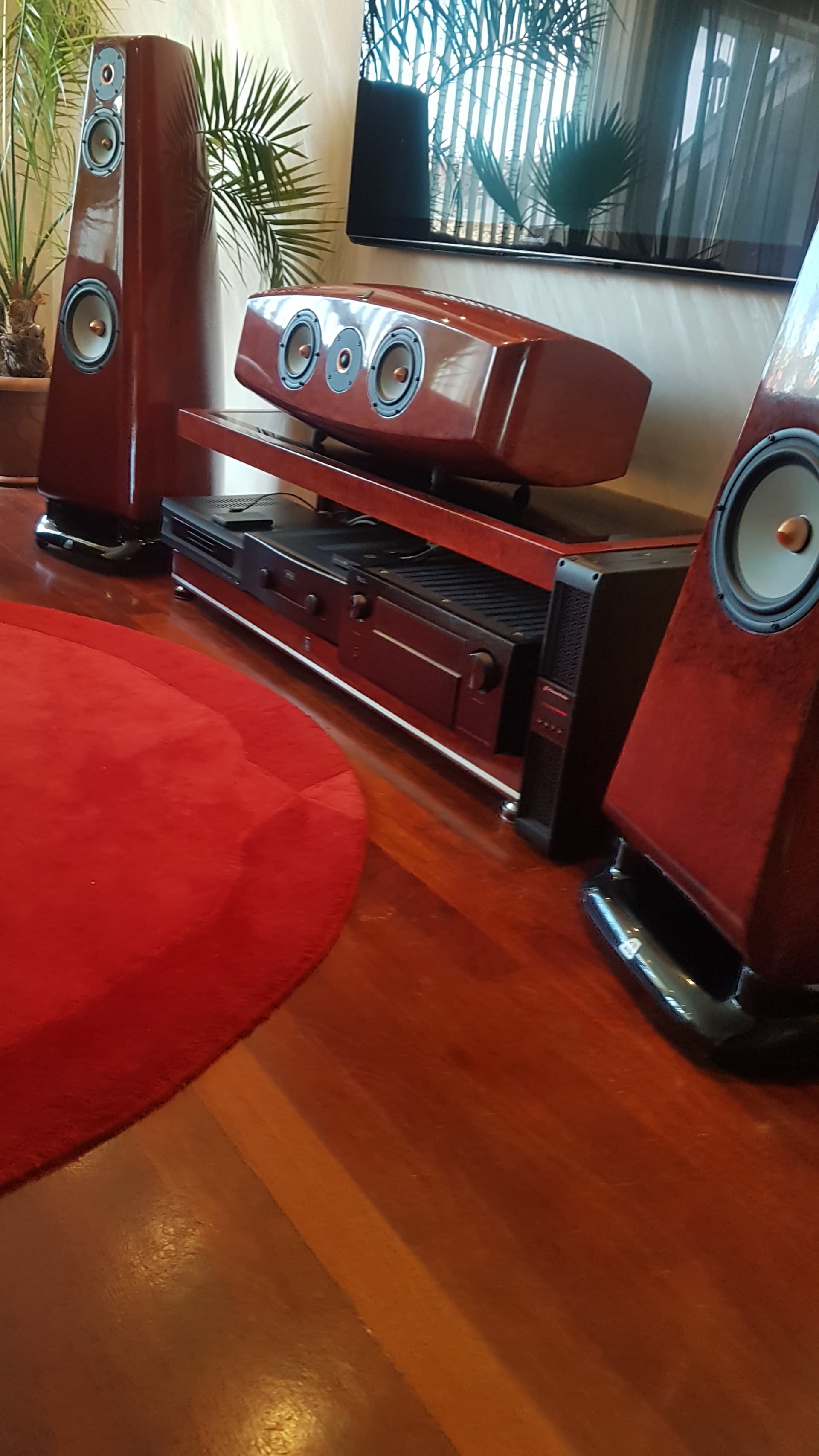

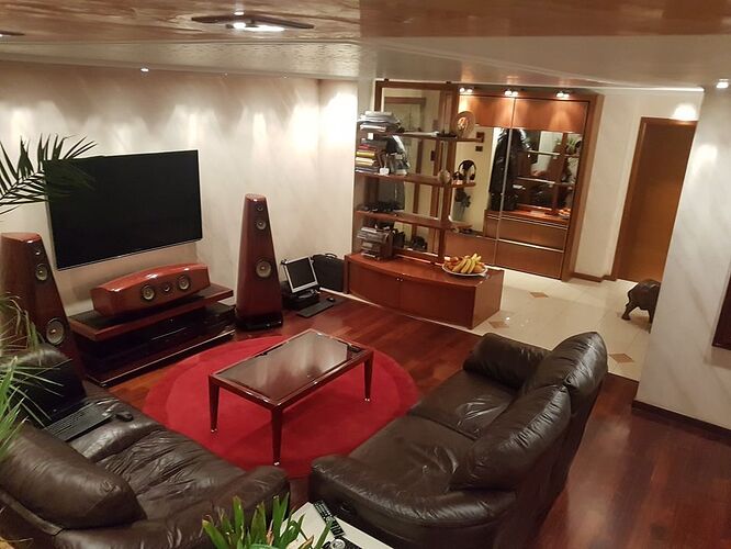

Actually, I repeated the logo theme because I wanted to bring you back to the initial project, I have an upgrade as options, an upgrade of my hi-fi system, and I will introduce yousome pictures of the room where I listen to music, everything in it is made by me, follows ;
My new acquisition; Denon AVC X8500HA and UPS- Power Walker VFI 2000RT HID.

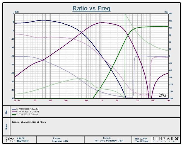

Thanks, Baldy! It is possible with this graphic to get an idea of the sound;

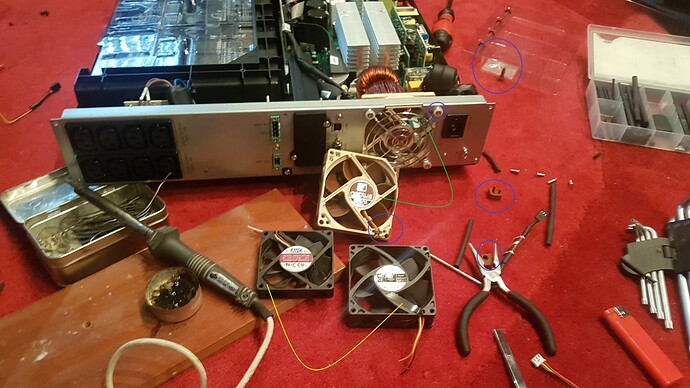

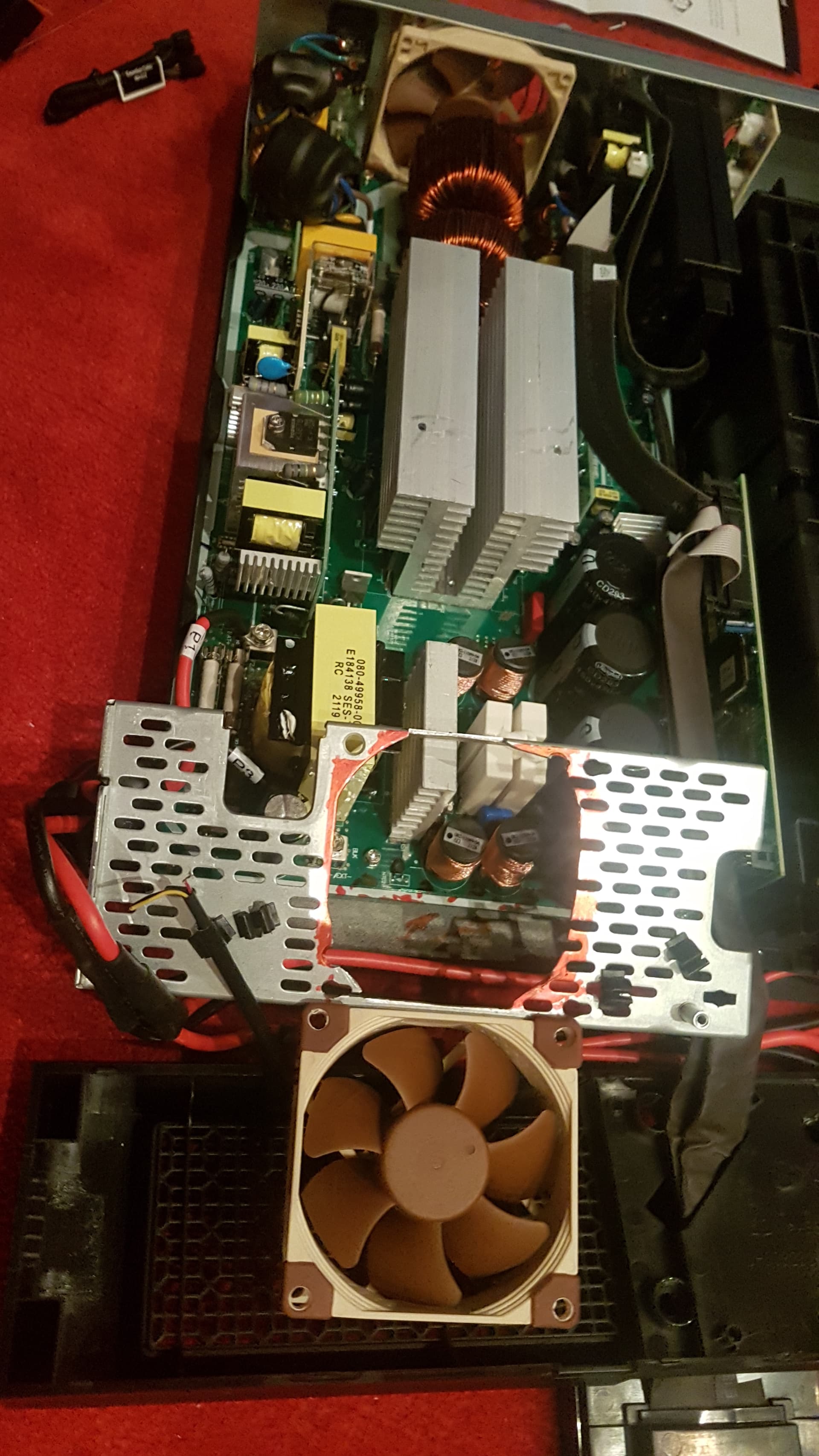

I decided to replace the fans, of course I lose the warranty at the moment, but it does not concern me.

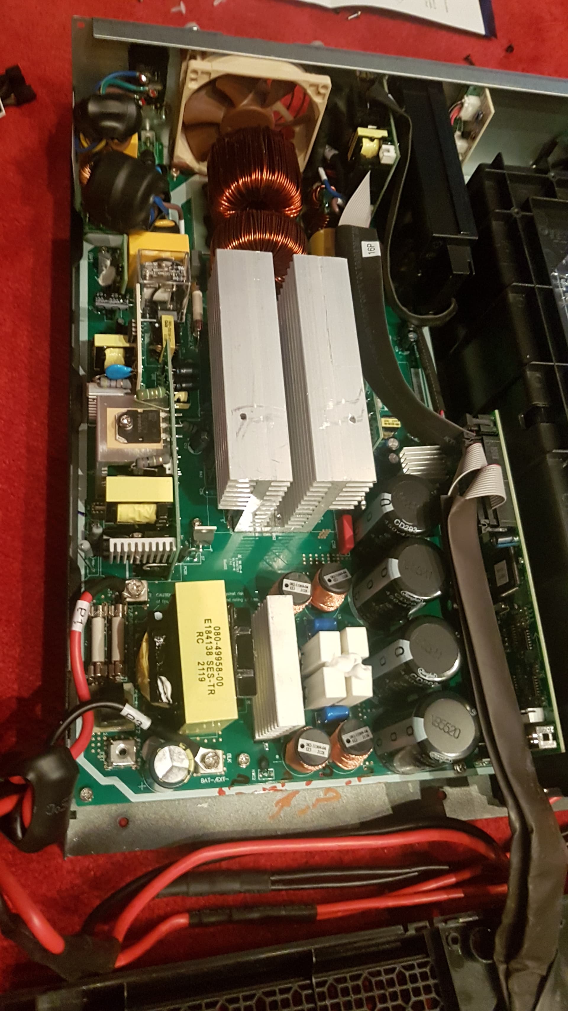

I opened the machine and found that such a construction could not be created by German engineers, indeed such elementary mistakes in the creation of the architecture of the motherboard and its cooling could be created by some mediocre mind!
The lack of enough space due to the motherboard has made the manufacturer install two different types of fans, the intake 70x70x15mm, and the exhaust 80x80x25mm!
The noise is already constructively embedded in the production of UPS, there can be no difference in the amount of incoming and outgoing air!
Naturally, no technical data on the fans themselves/ even on the official website in Taiwan/, the installation is directly on the case with screws, in one word - horror!
The photo shows / I have marked in red / the reason for installing a small and narrow fan, idiotic…
On the picture;
The yellow line - the factory fans.
The blue line - the gaskets for the new fans.
The green line - the new “Low Noise” fans.
And a simple solution - cutting out the metal front panel, pulling the fan in the front direction and … we have with the same indicators twins fans in the machine, 80x80x25mm with a noise of 19 dB.
When I tested the new fans with battery power the display was blue, but when I plugged the UPS into mains power it turned red with a fan error message. The resistance of the new fan is different and the software is reporting it as a system error, I’ll see if I can get through my computer to correct but if I can’t - no problem, here’s what it will look like;

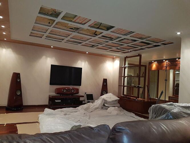

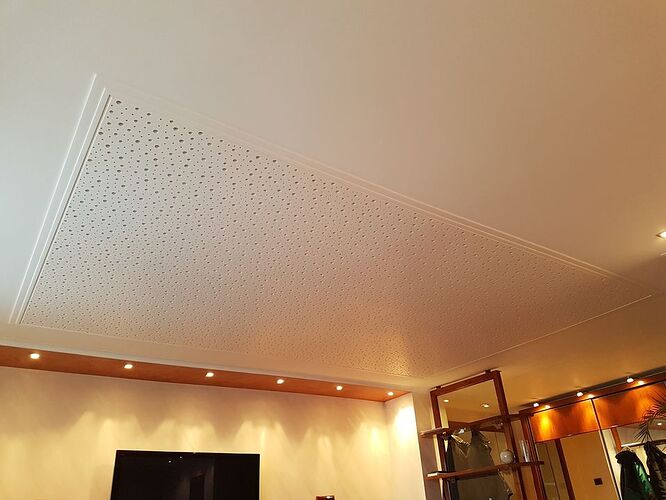

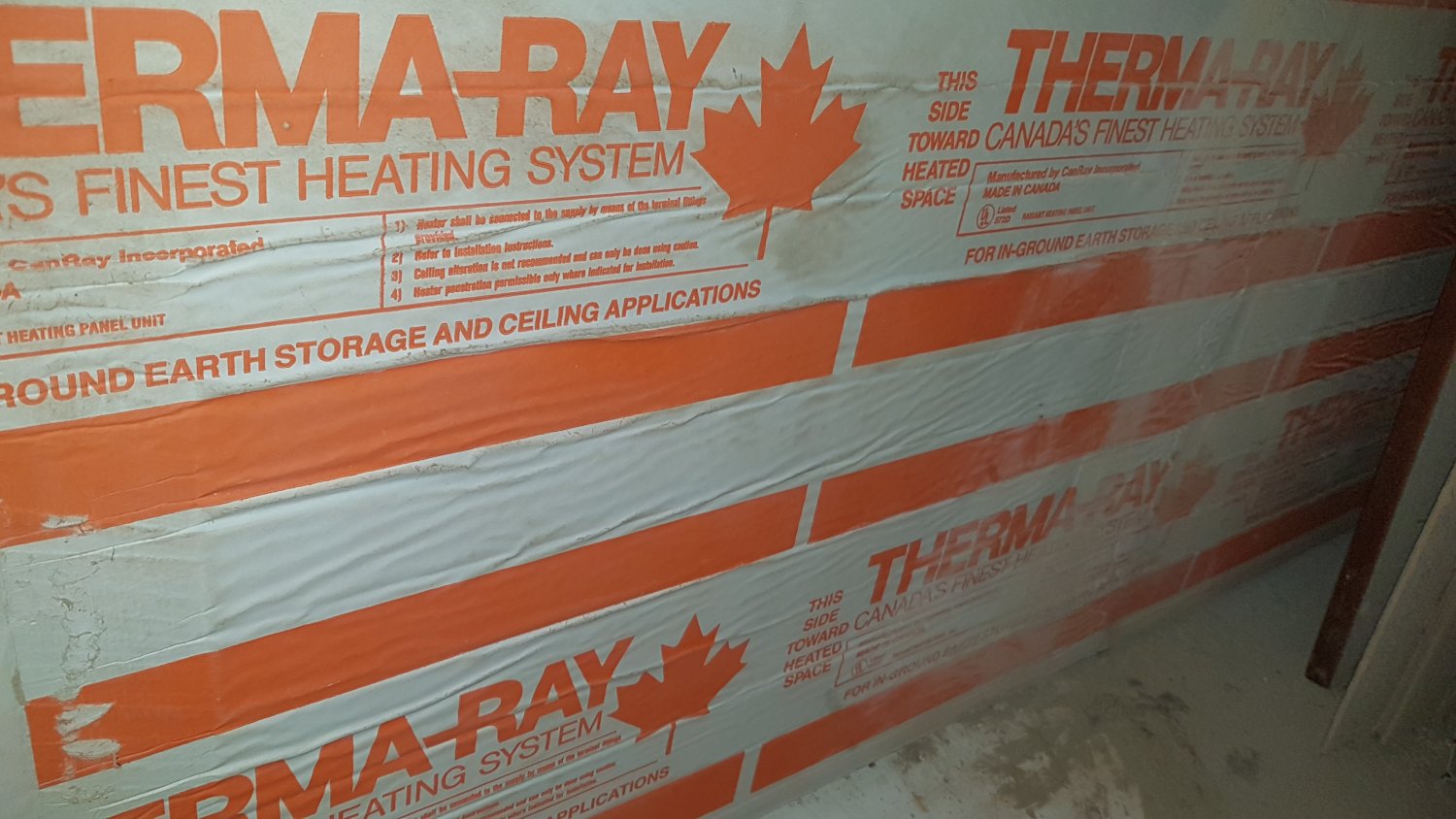

One of my solutions, a combination of heating and an acoustic absorber, the ceiling absorbs frequencies above 4000-5000 Hertz.
Heating panels work in the infrared spectrum through Radiant heat.
