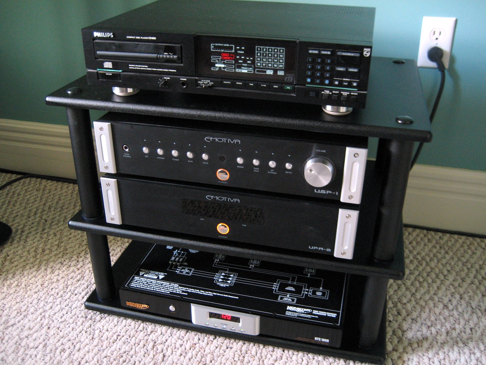

Great idea for component placements! Thought about that but instead, went with a 4-shelf Monoprice audio rack (see pic). This arrangement messed with the huge soundstage when set between the monitors, but sounded Absolutely Stunning when placed to the left side of the 10ft wall (under double french door windows) leaving “nothing-but-air” between the monitors!!!
Agree on the sub placement (see post #39)! However, “stage left” in my room is a 32" entry door way…no can do!
I have new speaker wire on order to accommodate the extra reach to the right monitor and will have room set up pics once complete! :ok_hand:
