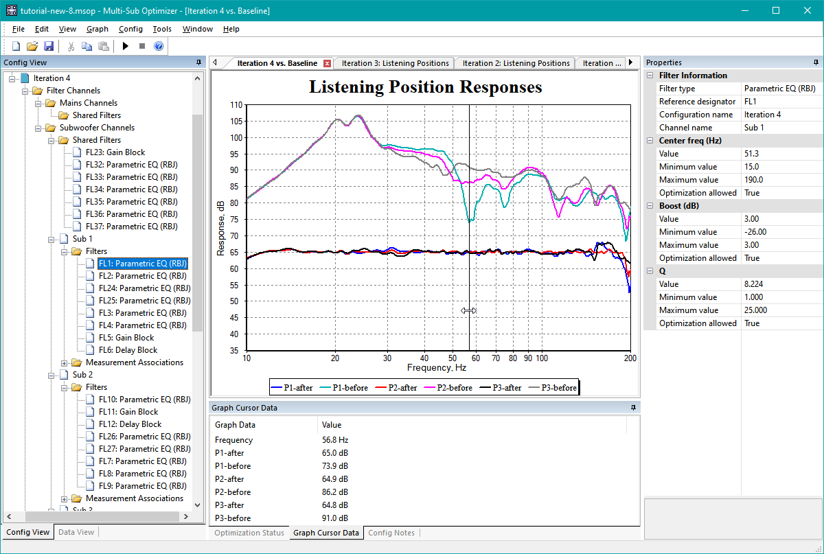

The biggest challenge of small room acoustics is bass, specifically the spatial variation caused by room modes - some spots have no bass at certain frequencies and huge bass at others and variation can easily be 20+ dB from position to position.
Harman did an interesting study on using the constructive/descriptive interference from multiple subs to largely solve this.
The REL stack doesn’t solve this but it does give you more output and dynamic headroom. When you space four subs through a room, they have smoother spatial response but the output is no more than that of a single unit.,
An even better solution to the Harman or REL approach (when you’re considering more than one listening position) is called Double Bass Array.
https://audioxpress.com/article/simulation-techniques-double-bass-arrays
This cancels all the bass modes in a rectangular room and so you have essentially the same bass response in all locations. However, this requires 4-8 subwoofers.
Trinnov has an approach based around this they call waveforming.
In short, yes, multi subs can be incredibly useful.

My pleasure. This is a great topic. I was thinking about doing some youtube videos about advanced subwoofer setup. It would be timely with us launching a sub around the end of the year.
I might also do a white paper or some guides on advanced setup stuff like using the REW for room simulation and measurement or a tool like the multisub optimizer with the app controlled DSP functionality in the sub.
