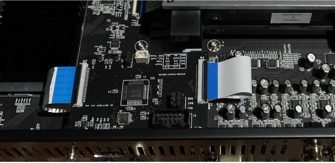

If you want to use the DAC in the DSJR here is the solution! I did it to my Oppo 203 and it’s a simple DIY. Oppomod.com I2S card will let you extract the DSD information off your SACDs and send it directly to the DSJR! The difference will be night and day over the stock Oppo sound! Warning tho this card is the gateway drug to other Oppo modifications which you will see on oppomod.com Lee is a great guy and shipping is fairly quick considering it’s coming from South Korea. $220
http://www.oppomod.com/images/i2s-card-large.jpg

It connects in before the dac so it sends the DSD signal right off the disc. You do have to make a small opening for the HDMI(I2S) port. I used a dremel tool.
