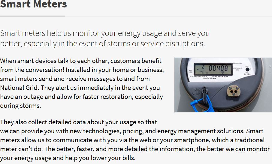

Main benefit of smart meters to the utility providers is that it allows them to eliminate an entire section of employees. Here other than a couple of former senior employees in that section who they now employee as contractors that entire department of meter readers was abolished. Saved them a bundle on health insurance, vehicles including maintenance and insurance and retirement benefits. They are now phasing them in on the water meters too with the same ultimate result.
I call B. S. On their benefit statement. Ask for a non-Smart meter to replace the smart one!

In Texas asking for a dumb meter is not an option. All new construction uses smart meters, even commercial, and they are retro fitting existing structures with smart meters.
You can ask your local service company to have the smart meter removed. I did that 2 months ago.
Here in central Ohio it costs $46 to have the meter swapped plus a $24/mo surcharge for not having a smart meter.
Here in New York City it cost me $105 to have the meter swapped plus a $9/mo surcharge for not having a smart meter.
There was an approximately 30% increase in my bill when changing to the smart meter so the savings from switching back will well make up for it not to mention your health benefits.

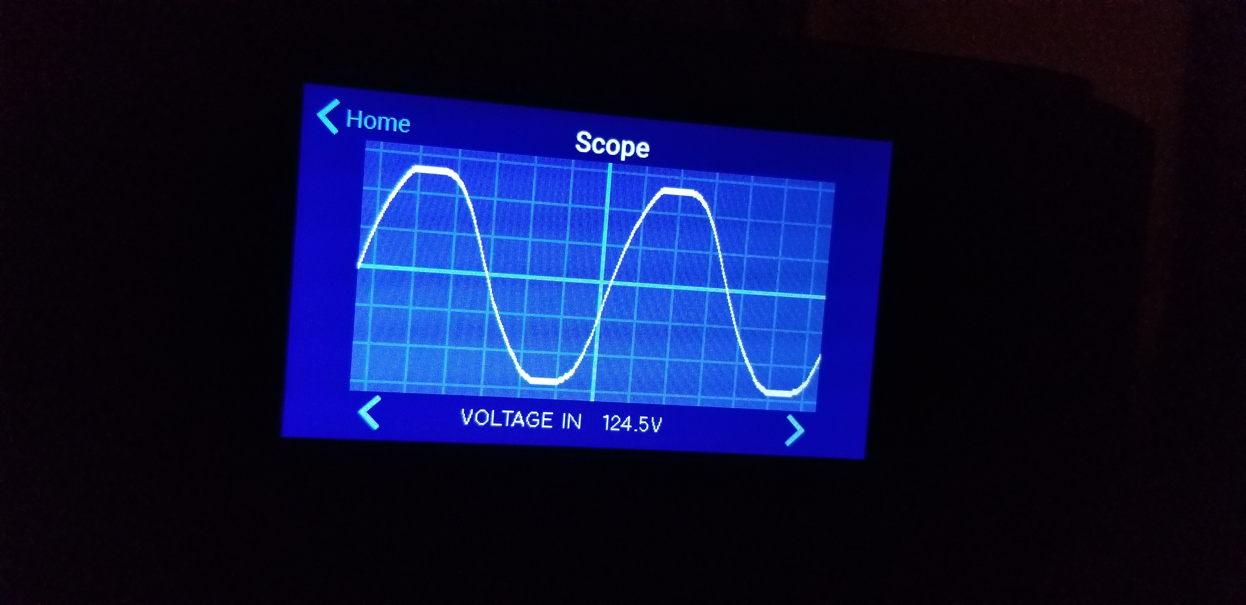

Here is the next set of displays from the PP12. The issue did happen again a couple nights ago so I collected the screens as promised for comparison to the earlier baseline record.
20190211_194511 20190211_194451 20190211_194502
The only thing that stands out to me is the curious flat-lining that shows on the bottom half of the difference screen.
Thanks, I appreciate you grabbing the pictures. How frequently does the issue come up? Seems like it’s not quite every night.
I wonder if perhaps there is a certain device you or one of your neighbors is running that causes these issues…
Also, have you noticed the time at which the problems start changing at all? If it is linked to the solar farm that your power company built, I would expect the kick off time to change as the days get longer.
That’s pretty typical of flat topping from lower power factor devices by your neighbors. Thank goodness the Power Plant is there to fix it.
Latest update: National Grid showed up on 3/28 and installed a temporary voltage monitor at the feed point outside of the house. They pulled off the glass dial meter, put the device in position, and reinstalled the glass dial meter on top of it. They say it will remain for a week to collect readings.
