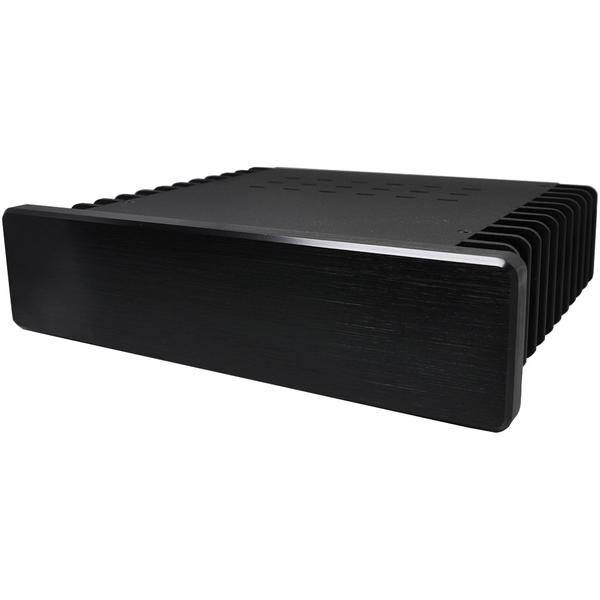

I was planning in getting a ROON Nucleus Plus, but I was convinced to instead get a RS8 server, w 2 TB of internal memory.The core has an Intel i7; It has 8GB of DDR4; It has a very fast 256GB NVMe SSD drive.
It loaded my music very fast. It was very responsive and I had it hooked: Ethernet from modem to the RS8- ROON server, then USB to Matrix and I2S to the Directstream. The Music coming out was sounding great, wide soundstage. The only huge problem was that it run hotter than my mono blocks. Within 2 hrs it was screaming for a fan. They advertise that these units like the ROON nucleus plus run cool, and this one does not, I will have to return it ASAP.
Anybody has experienced units like these getting very warm?? Does the Nucleus plus gets very warm…??

Has analysis completed? This will light up all cores and run the proc as hot as nearly anything else.
If you have tons of music, analysis phase takes time- and runs hot
I think you re right after downloading about 2 TB if music, it took almost 22 hours and it got as hot as 113 deg F, now that the download is done, it’s starting to cool down. We ll see what the temp is tomorrow.

After the loading period of over 22 hours of music and seeing a peak temp. of 113 deg F, the next day, it took several hours and it cooled off to now having a temp. of 79 deg F.
The music coming out of the RS8 thru the matrix and I2S into the Directstream sounded very good and w/wide soundstage. I’ll need to get an Sbooster to power the RS8 and see if it improves a bit more.

I purchased the RS8 Roon Music Sever a couple months ago. Many people write they can build music servers DIY for $1k or less, trust me the RS8 is World Class for the serious user & well worth the money. The RS8 is one of the few music servers that allows for setting the speed of the processor. I have the RS8 12 TB SS Array to go with the RS8 Music server and everyone should really read the instructions, you MUST set the in the Roon App, the speed to Throttle rate to maintain a proper processor speed. If you run the processor speed Off Throttle and transfer 2TB of music, 113 degrees is normal. Set it to throttle in the Roon App and no matter what you transfer, the RS8 will run cool during analyzing.

When you create a new Roon Server and add a library Roon gets very busy indexing your collection, hence the heat. My server allowed me to set how hard it would work during this process and I started slowly, but soon went full speed after placing cooling fans above and below the server. When the Library work is done you can choose full speed without fear of overheating.
What may surprise you is there are a number of people who believe when using P7 chips at full speed the server is noisier. If your server allows throttling the processor many believe cutting it back to 1/4 its potential speed gives you a lower noise system. Some go so far as to say low power processors sound best as long as you are not doing a lot of HQplayer processing.
