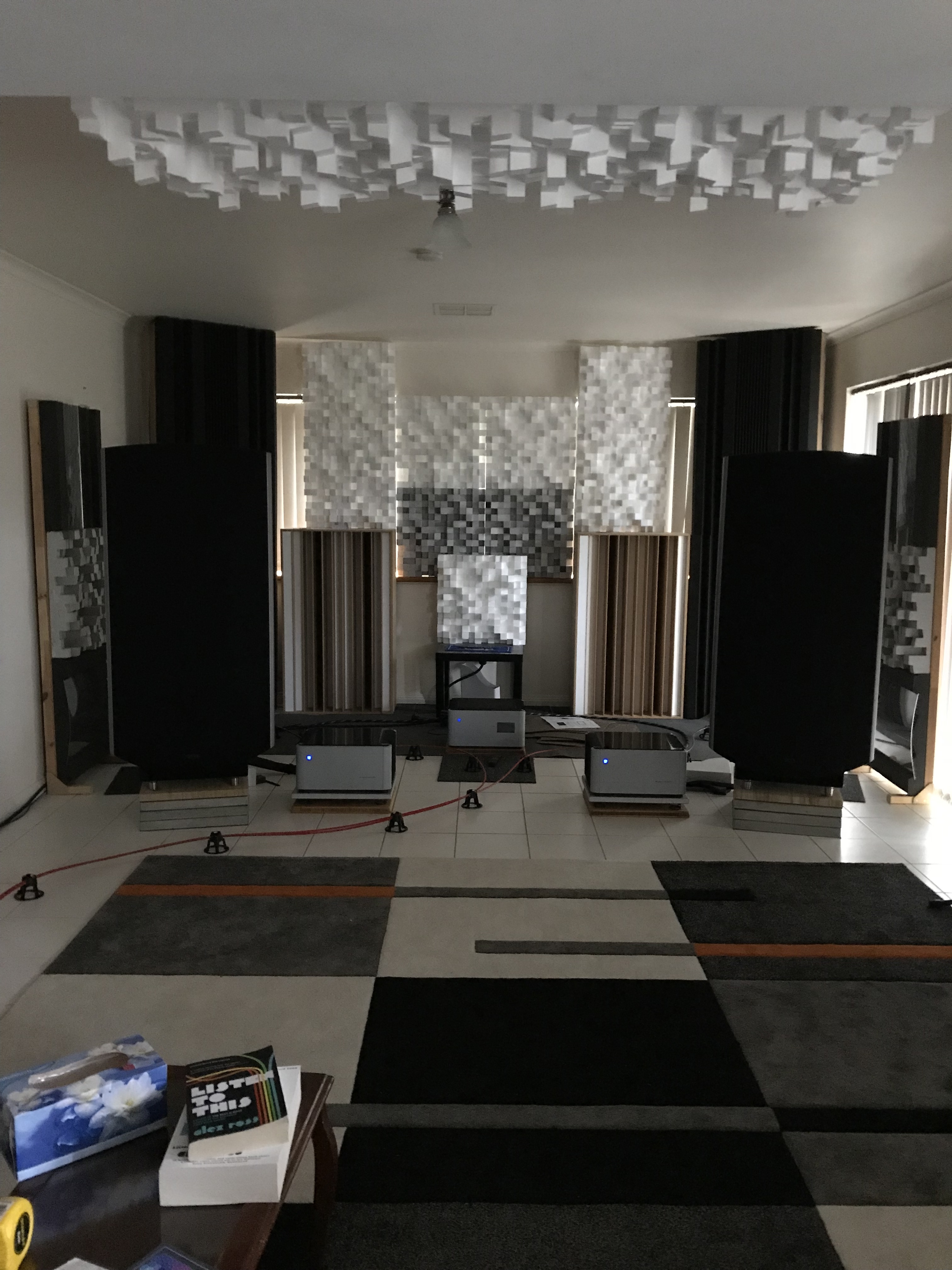

Currently listening to Eagles - Out of Eden powered by solar/battery on a cloudy day in ADELAIDE, South Australia.
System consuming about 250w /hr (overnight total consumption is about 500w /hr with system in standby). Been very wet so the battery isn’t very well charged atm, mostly running off the grid.
