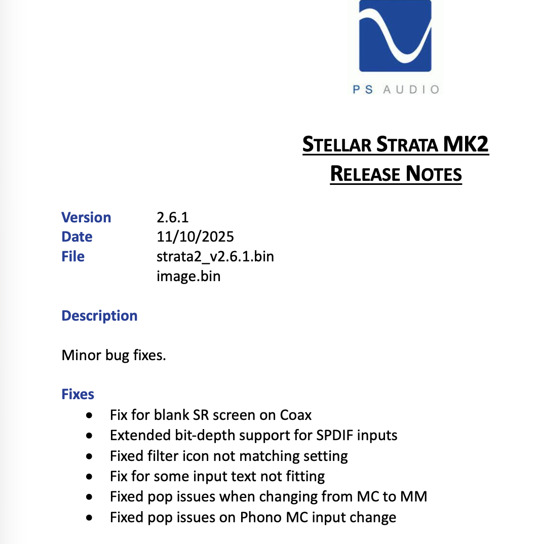

PSaudio released a new firmware update for the Strata mk2 integrated: v2.6.1.
Since I’m experiencing some issues with the sample rate and bit depth with my CD player and the Chinese i2s converter, I’m going to try this one ![]()

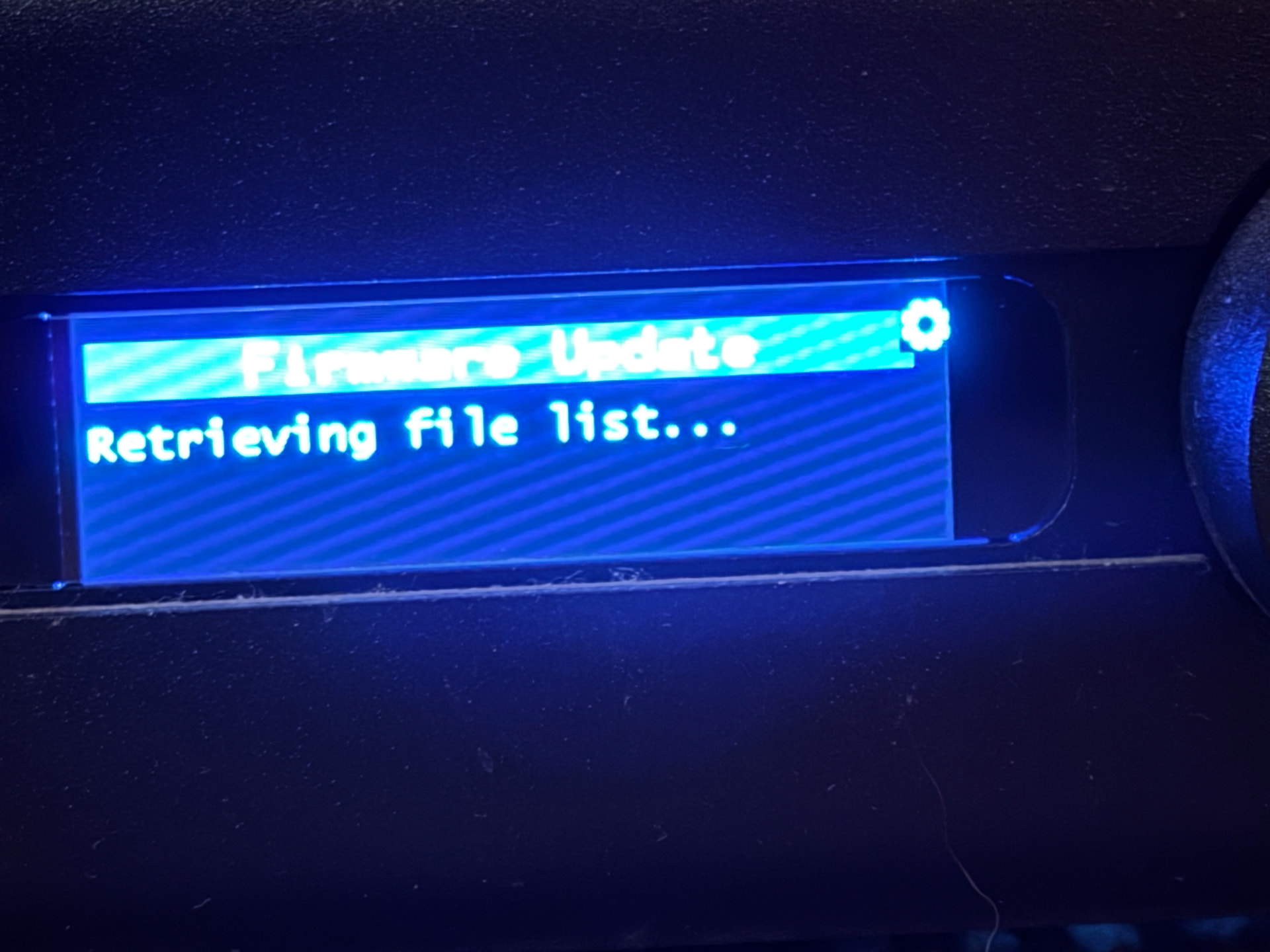

so far I did not succeed… the Strata recognises the drive, but it hangs in “Retrieving file list…”
I contacted the PSaudio help desk, maybe I’m making a silly mistake ![]()

Since my original post I’ve been in contact with Support Specialist Delia. Although she pleasantly does all she can my Strata still doesn’t want to load the update. I think I’m doing something clumsy; apparently the Strata doesn’t like the “ghost” files that MacOS puts on the disk and I’m not a Windows-guy ![]()
Later this evening I’ll try to install the image.bin file again ![]()
I just tried “method 2” again: Formatted the USB stick as FAT32 using Window’s PowerShell. Copied the image.bin file to the stick. Unfortunately when the Strata starts up, from the white PSaudio logo screen it just jumps directly to the previously selected input channel… I hope Delia will find a solution ![]()

After putting it aside for some time, I gave it a try again this weekend. The two procedures that are in the Firmware Update Instructions again didn’t work: the Strata just doesn’t recognise the USB stick…
Then I noticed the “factory reset”, the Strata would restart automatically after performing a factory reset. I was wondering what would happen if I would leave the update stick in the Strata during the reset. It worked!
