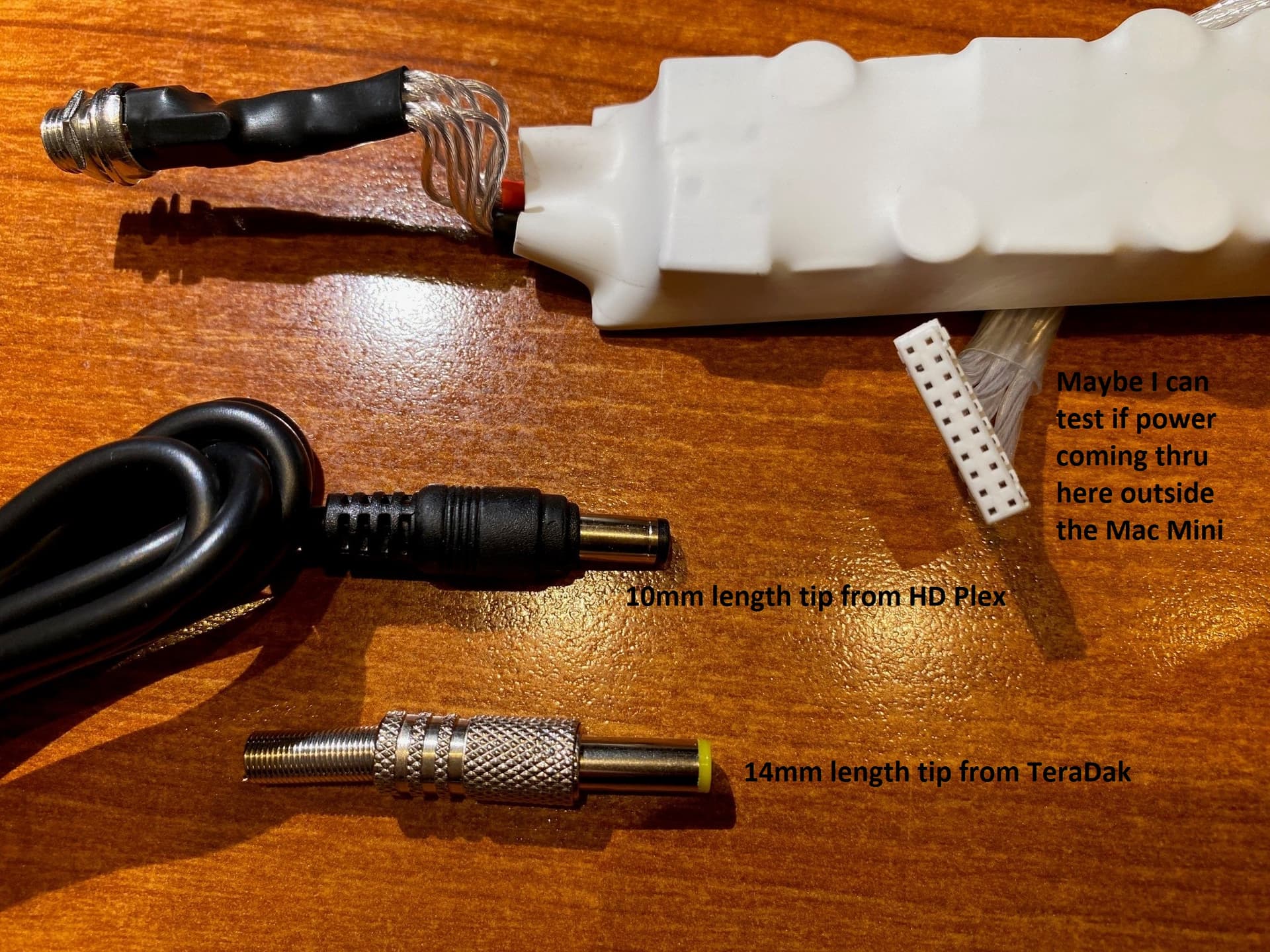

@vmax I opened up my Mac Mini a few times today for surgery. Tried replacing the SMPS with a TeraDak at the same time as upgrading the RAM to 32GB. Mac would not restart though. Looked like power not getting through as a USB stick with an LED did not light either. Even if RAM were static-fried, the USB should have lit. I put the SMPS back in and the Mac still did not start. Held down the power button for ten seconds though and it did restart. The RAM upgrade is OK then. One consideration is that TeraDak sent a connector with a 14mm long tip. Whereas the base cables from HD Plex have tips that are only 10mm long.
Questions:
  • How long are the tips you have with your custom cables? I was waiting to upgrade after getting everything working…
  • What model Mac are you powering with the HD Plex?

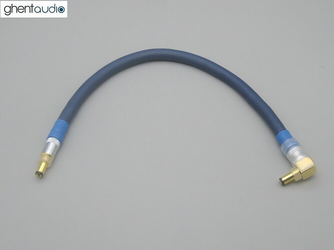

I have a zm-1 Macintosh I didn’t use the HDPlex cable but
This one.
