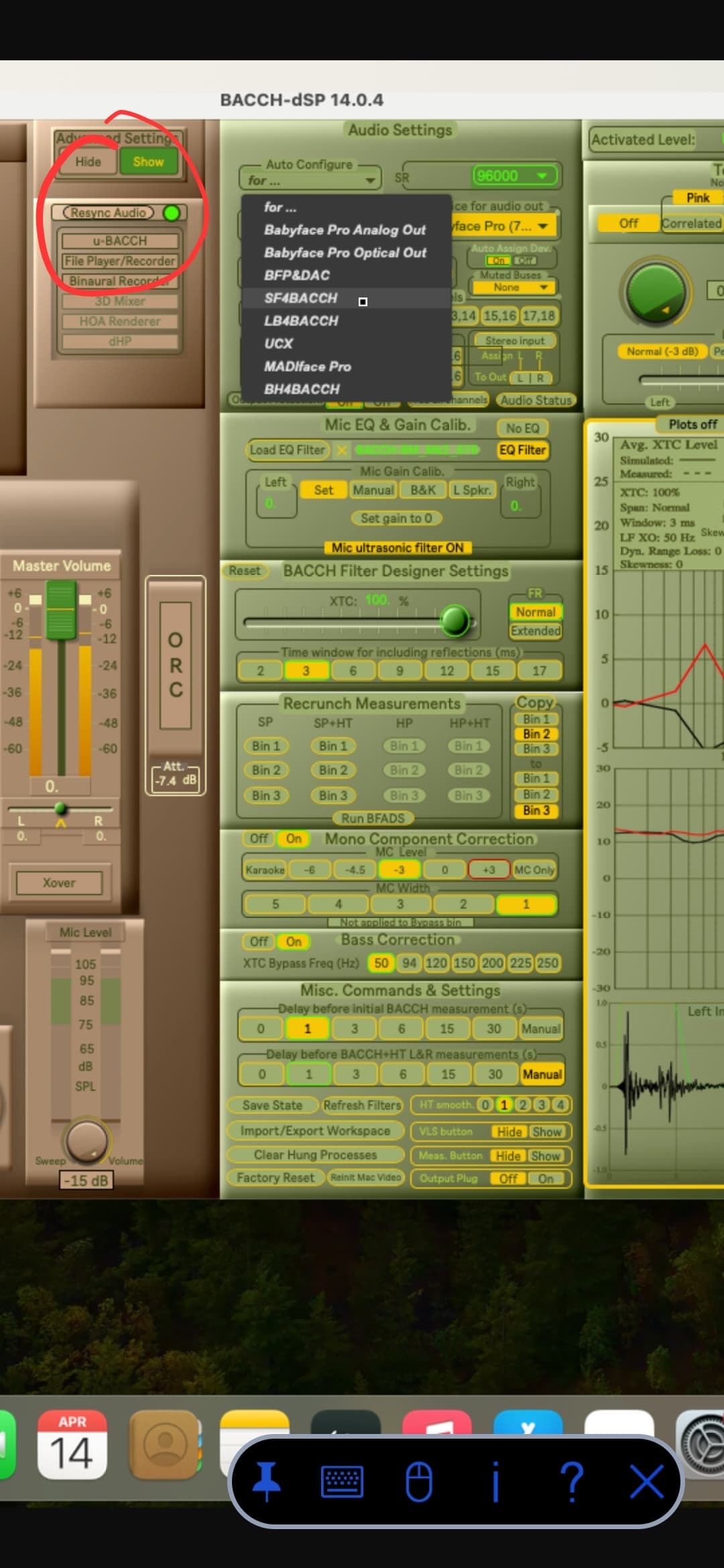

You have to install the roon bridge software. Then roon will find your mini.
It will work with black hole. You have to create a composite device, BH+your dac. Name it SF4BACCH (exactly like this). Then you run the script in auto-configure with that name. You should have sound.
But first you could try hitting the resend audio button in the main window, upper left.

I still have not solved the microphone in. “Free All Channels” did not result in my being able switch to inputs 9 and 10 from the RME Fireface 802. I will wait a bit until Theoretica folks are back from Axpona.
Yes, I use SF4BACCH already with my other interface and an external PSA MK2 DAC. I did need to use it to get Roon to play with the RME today too. Otherwise, by selecting the Fireface 802FS in Roon, the music did not get all the way into BACCH. Surprised me a little bit. I guess it is because there is no pre-configuration for the Fireface 802FS, “only” for the Babyface, the Fireface UCX and the MADIFace.

Doh. All I needed to do to unlock the mic input was to click on the word,“locked“
Who could have imagined that…

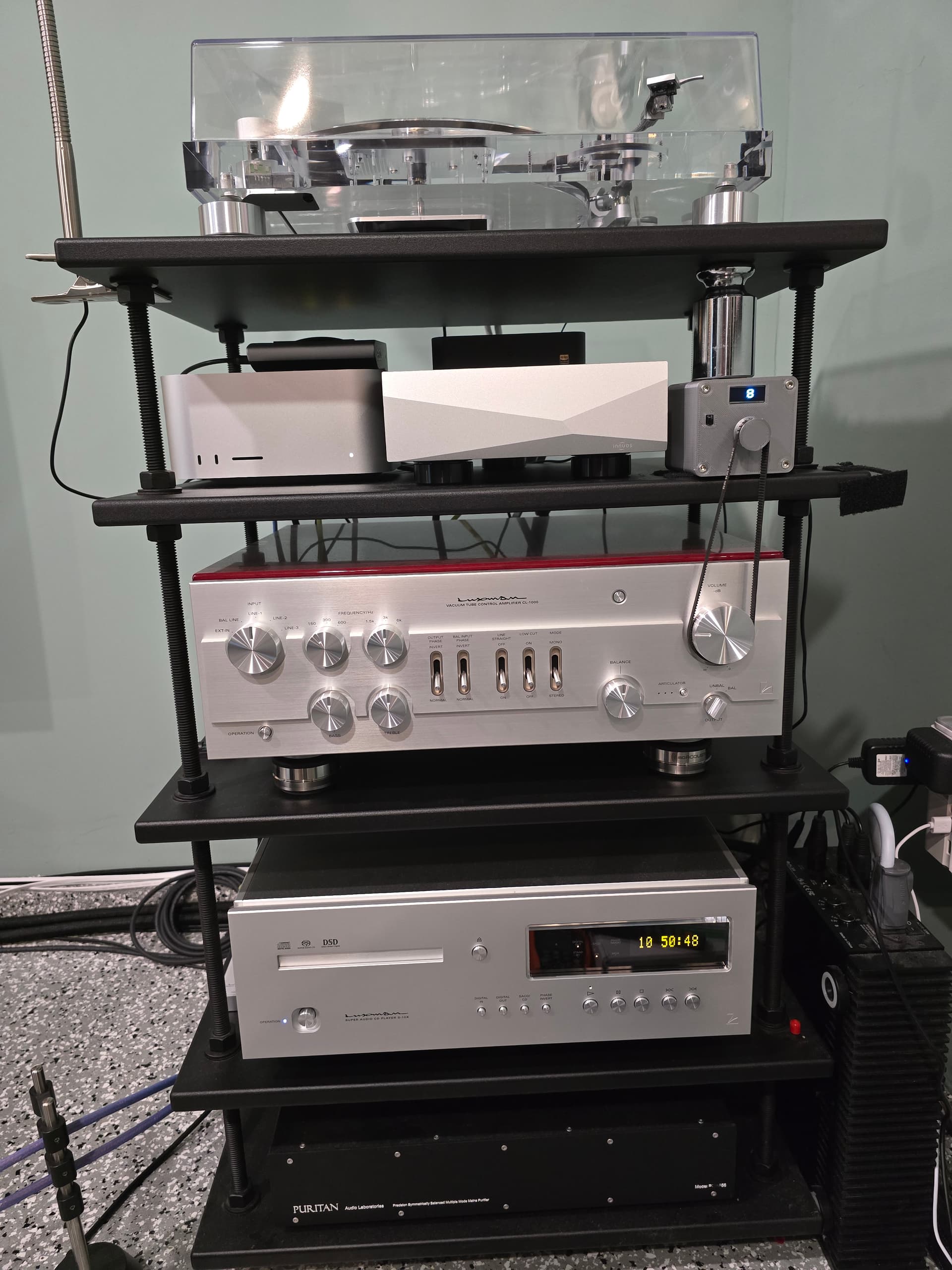

Love the rigged volume control on the Luxman.
Hehe yup. I like it too, wrote code to handle the stepper motor volume control and display. Working perfectly so far.
Times 2 on the remote. And also love the look of that amp. Timeless beauty.

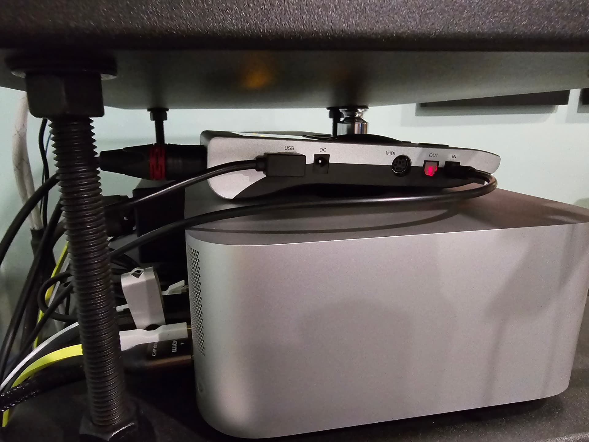

Nice. What is this cable on your baby face input?
Do you have the bacch software installed?
No software installed yet. Cable is a cheapo toslink going from the CD transport to the babyface for eventual transfer to the MAC for XTC processing. I will need to connect my turntable too to it but not sure how yet. My guess is I will need a pair of 1/4" to RCA adapter so I can use inputs from the other side.
That is what I am doing. It’s fine. The BabyFace Pro is an excellent device!
Nice. Edgar will advise on the turn table. My guess is that you could use either the instruments inputs (1/4) or the same XLR input you use for the mic (turning off the 48v phantom power).
But he will guide you through.
I didn’t think of using the mic inputs! Good get!
