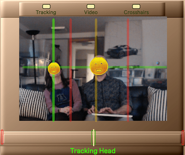

I’ve come to the conclusion that the BACCH is not for me - us I should say. This is the fourth time I’ve heard the BACCH, at shows. In the four times I’ve heard it I’ve been “calibrated” to it two of those times by Edgar. It does everything everyone says it does, of that there is no denial. But this time around I asked Edgar “what if two people are sitting together, can the algorithm account for this?” He said no, that it is optimized for a single listener at the calibration location. He did say that the effect is still there, but falls off, as one moves away from that location. And that’s true, too, as I’ve heard it myself. But ultimately it is designed to work its best magic for a single person in a single location. IOW, most audiophiles (which to me is kind of a sad commentary on our hobby). That’s not us. In my audio world it means either my wife or I would be in a fall off location. Granted, it probably won’t be too impactful, but until Edgar figures out if there’s a way - should he choose to do so - to create a solution for groups larger than 1, I’ll have to pass. I could easily get a dio, but for me it just doesn’t answer the mail. My mail, that is. Everyone else’s MMV.
That is about what I would expect Edgar to tell you. We are not too fussed about it ourselves though. We do sit closely together. And the head tracker does get confused. Here she was being tracked and still is being tracked despite leaving the left-right frame. It still sounds real good. That is all that matters. Note: We tried to get the cat to participate for this picture. But the tracker did not seem to want to pick him instead of us.
Hey, that’s good to hear. It will be worth reconsidering then.
I have seen the same thing happen during head tracking. i have still been impressed with sound when others are fully in the sweetspot. Me being the pickiest is still enjoyed stereo better than I had prior to head tracking

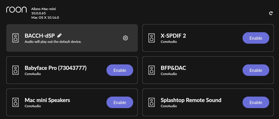

What is this Roon endpoint function? I think I’ve never seen it. I am using with either BFP or Blackhole to route the audio through bacch software, and it would be nice to get rid of both and keep things simpler.
The Bacch4Mac and BACCH-SP adio and dio have a Roon Endpoint built in. It is fairly easy to get working with Roon.

The BACCH device should show up in your Roon Setup under settings >>> Audio:
See the upper left hand corner “BACCH-dSP”. You may have to enable this device to be able to choose it.
