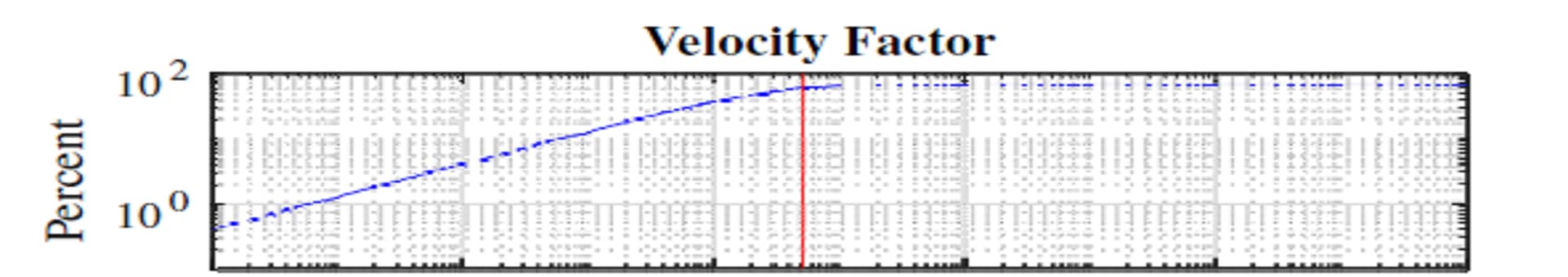

We have to be careful with all this. It is TIME for sure, but be somewhat cognitive that it is a percent the “C” value of about 3.00 E8 m/s. That’s FAST, even if we see just 5-10% of that in the bass regions.
Yes, we can change the data lines slope some to be better in the audio range but the total differences in the numbers are still small even if the percent of difference are seemingly large. This is why longer cables aren’t a total disaster!
We have two separate issues. The PHASE is the alignment of all the frequencies at the very start of the test. At RF the phase is zero with frequency. At audio it moves from near zero at 20 KHz to -45 degrees at about 20 Hz. All the frequencies aren’t lines up “straight” at the starting line.
The second part is once the frequencies move down the cable, they travel at a different Vp (group velocity) until we get to RF, where the RF Vp is very close to the SQRT (1/ dielectric constant) and can reach 95% the value of “C”.
Both superimpose one top of one another. It is really happening, but it is hard to pin a “value” on what we hear even if we are time based in our hearing more than just amplitude. Does aligning the Vp improve things? The numbers, like so many of the numbers in audio, seem too small a change to matter. Cables sound different so SOMETHING(s) matters.
My experience seems to say timing changes in a cable move what I want to hear in the right direction. Or, is the better design for analog frequencies moving other unknown variable(s) we hear “more” than time-based improvements? I can’t design to that, though!
The series I and II ICONOCLAST speaker cable and IC are definitely time based different based on the designs. Most report the series II seem to be better sounding cables. I can report what the designs do that we know of, but that’s as far as I can take it. What we hear is ALL of the rest added in too.
