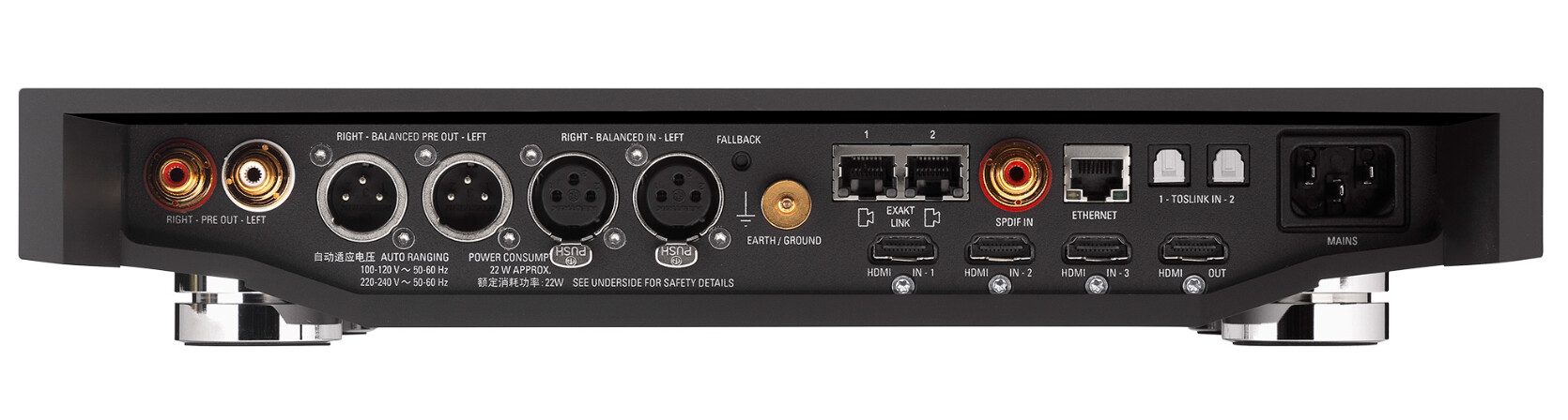

TSS Two Chassis Super DAC

On many DACs it is. But separation of clock from data is irrelevant to the DS, the DS doesn’t use the edges of the clocks or data. Each signal in HDMI cables is balanced, which is good for noise rejection and lowering noise radiation. HDMI cables have good shielding and better ground connectors which may help in some systems.
Ignoring bandwidth, TOSLink is probably the best interconnect for the DS. Many times when people compare inputs they leave more than one input connected which puts all cables at the disadvantage of the worse cables. Tho changing cables when doing an A/B is a pain, some might be surprised at the quality of an optical connection with no other cables connected.
