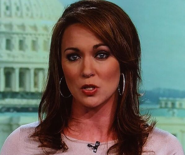

A couple of years ago, I did a comparison of picture quality with my Kuro PDP-151FD using the Power Plant Premier and P5:
Video Quality Comparisons of the P5 and Power Plant Premier
The following screen shots are from a paused image from a Tivo XL High Definition digital video recorder. The program was a CNN high definition (1080i) news broadcast. The native resolution of the Pioneer Kuro high definition plasma is 1080p (1920 x 1080 pixels). The pictures were taken with a Fuji Finepix S9000 9 megapixel digital camera. The camera's image resolution was 3488 x 2616 (9,124,608 pixels). Figures 35, 36, and 37 are reduced-size versions (800 x 669 or 535,200 pixels) of the original screen shots for faster page loading and are 1/17th the size of the original. It is easier to see differences in figures 35-37 and in figures 38-40 if they are downloaded and viewed in succession.
Screen shots were taken with the TV plugged into an ordinary household outlet, with the TV plugged into a Power Plant Premier (PPP) AC regenerator and with the TV plugged into a PerfectWave P5 AC regenerator. In each case, the power cord between the TV and power source was a PS Audio Statement SC. The Power Cord between the AC regenerators and the wall was a PS Audio AC-5. The wall outlet for the AC regenerators was a PS Audio Soloist SE in-wall conditioner, which terminated a dedicated 20 amp AC circuit. The PPP had been in use since 2008. The P5 was new with 100 hours of use.
The image with the PPP was more detailed than that from the wall outlet, but it was also darker, which indicated some current limiting by the PPP. Notice that there was no apparent current limiting with the P5 as the image was equal in brightness to the wall outlet image.
Figure 35. Screen shot of HDTV image with TV plugged into wall outlet.
Figure 36. Screen shot of HDTV image with TV plugged into Power Plant Premier AC regenerator.
Figure 37. Screen shot of HDTV image with TV plugged into PerfectWave P5 AC regenerator.
The cropped images below of the news anchor's left eye provide better insight into picture quality improvements going from the wall outlet to the P5.
Figure 38. Crop of news anchor's left eye from TV plugged into the wall outlet.
Figure 39. Crop of news anchor's left eye from TV plugged into the Power Plant Premier AC regenerator.
Figure 40. Crop of news anchor's left eye from TV plugged into the PerfectWave P5 AC regenerator.
Comparing the PPP cropped image (figure 39) to the wall outlet cropped image (figure 38), lower power line noise resulted in a smoother picture (less pixelation or "blockiness") and less smearing of pixel information. The three studio light reflections above the news anchor's pupil appear as three blobs of light in the wall outlet cropped image. The studio light reflections in the PPP cropped image are much sharper, more detailed and rectangular than the wall outlet image. There is less pixelation in the eyebrow. The curved edge of the iris is smoother. Notice however, that this increased detail comes at the cost of decreased light output. The PPP image is significantly darker than the wall outlet image.
The P5 cropped image has the same level of brightness as the wall outlet cropped image (no evident current limiting) and more color and shadow detail than the PPP cropped image. The curved edge of the iris is smoother than in the PPP image and much smoother than in the wall outlet image. The shapes of the individual bulbs of the studio light panels are more rectangular and the spaces between bulbs are more sharply defined.
The differences in light output, color rendition, clarity and detail among figures 38, 39 and 40 provide insight into why the plasma television picture was much more three dimensional, vivid and lifelike when each and every pixel was not distorted with significant amounts of electrical noise.
