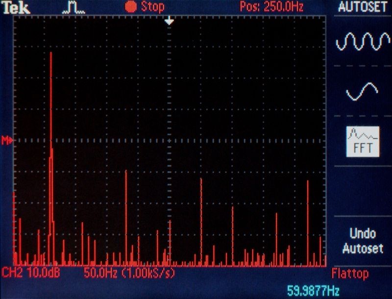

I did. Version 37 had lower noise amplitude and noise density than v39. The following oscilloscope measurements were taken over a 45 minute period. I must caution that the differences in output noise that I measured may not fully or even partially explain the differences in performance I heard. It only indicates that there is a difference in performance.
Figure 32. FFT plot of power signal from the wall.
Figure 33. FFT plot of power signal from P10 with firmware 37.
Figure 34. FFT plot of power signal from P10 with firmware 39.
Data from the FFT plots are summarized in tables 3 and 4:

I sent my MultiWave results, including oscilloscope measurements, to Wayne Colburn of Pass Labs. Wayne is the designer of the XP-30 line stage and XP-25 phono stage preamps used in my two channel audio system. His comments are below.
“I have used a PS Audio Power Plant in the past and found improved sound when used on line level components in standard mode. This was on older product like the X1 and X0.2.
The MultiWave was better on some things but not others. I ended up going back to standard mode. The XP-30 and XP-25 do have a more complicated power supply than previous products from us in that they have a capacitance multiplier before the regulators and this would probably diminish some of the MutiWave effect.” - Wayne Colburn
