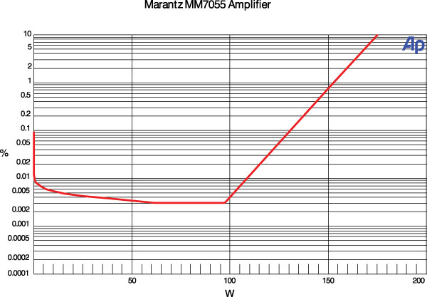

This gives some type of reference as to when it’s linearity (or better said non-linearity) starts it’s upward climb. (2 channel driven @ 8 ohm load)
411mar.measamp
My apologies, I intended to refer to distortion usually shown as 1khz continuous power. Class D tend to be very linear, valves not. See for example on Stereophile the Devialet D-premier and the Macintosh 275.
